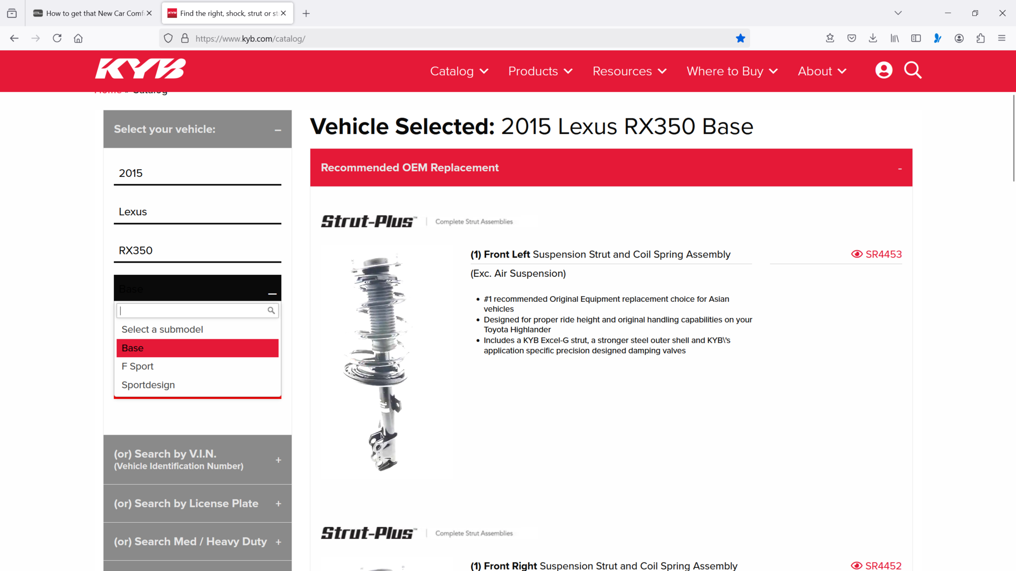

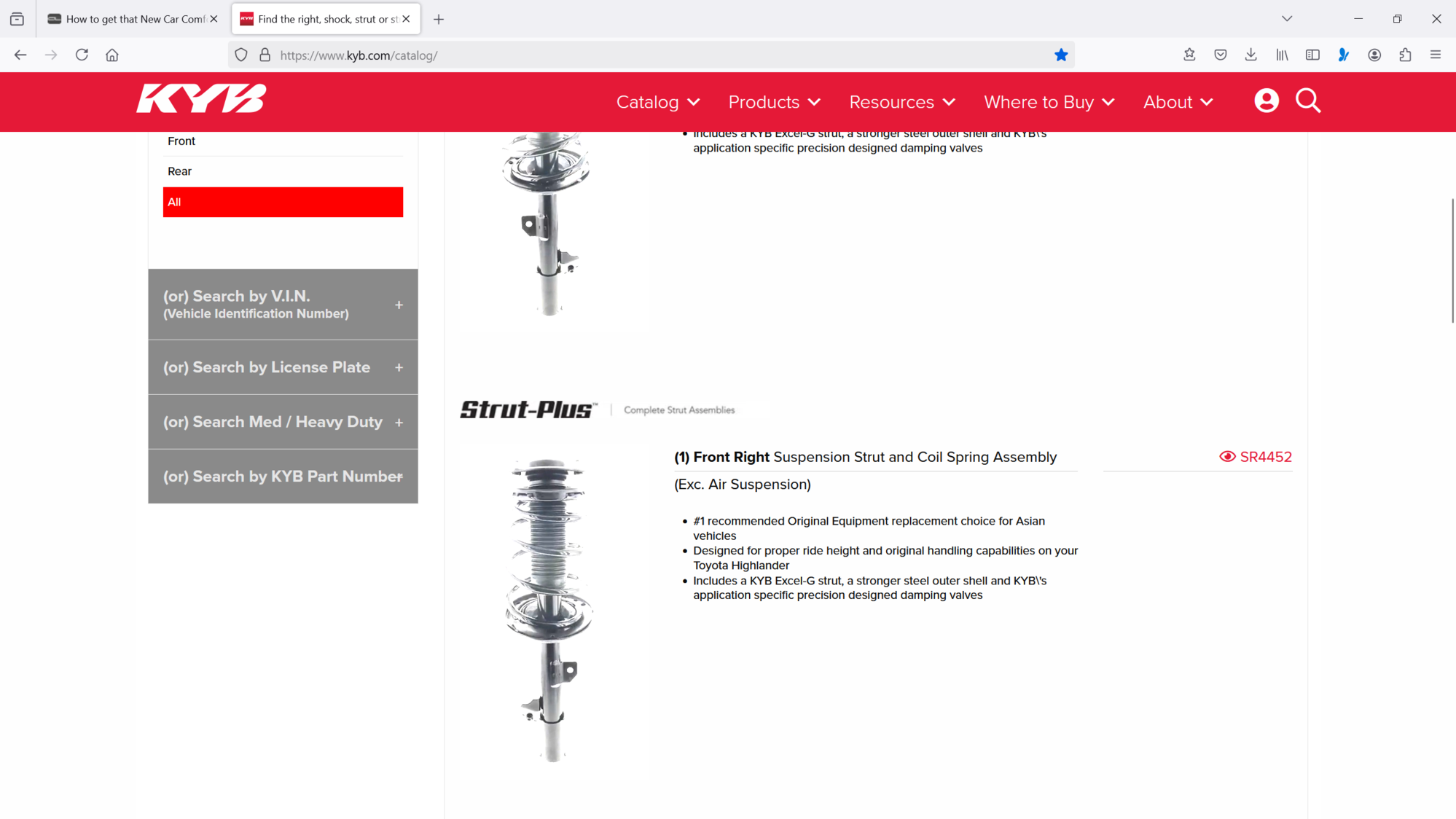

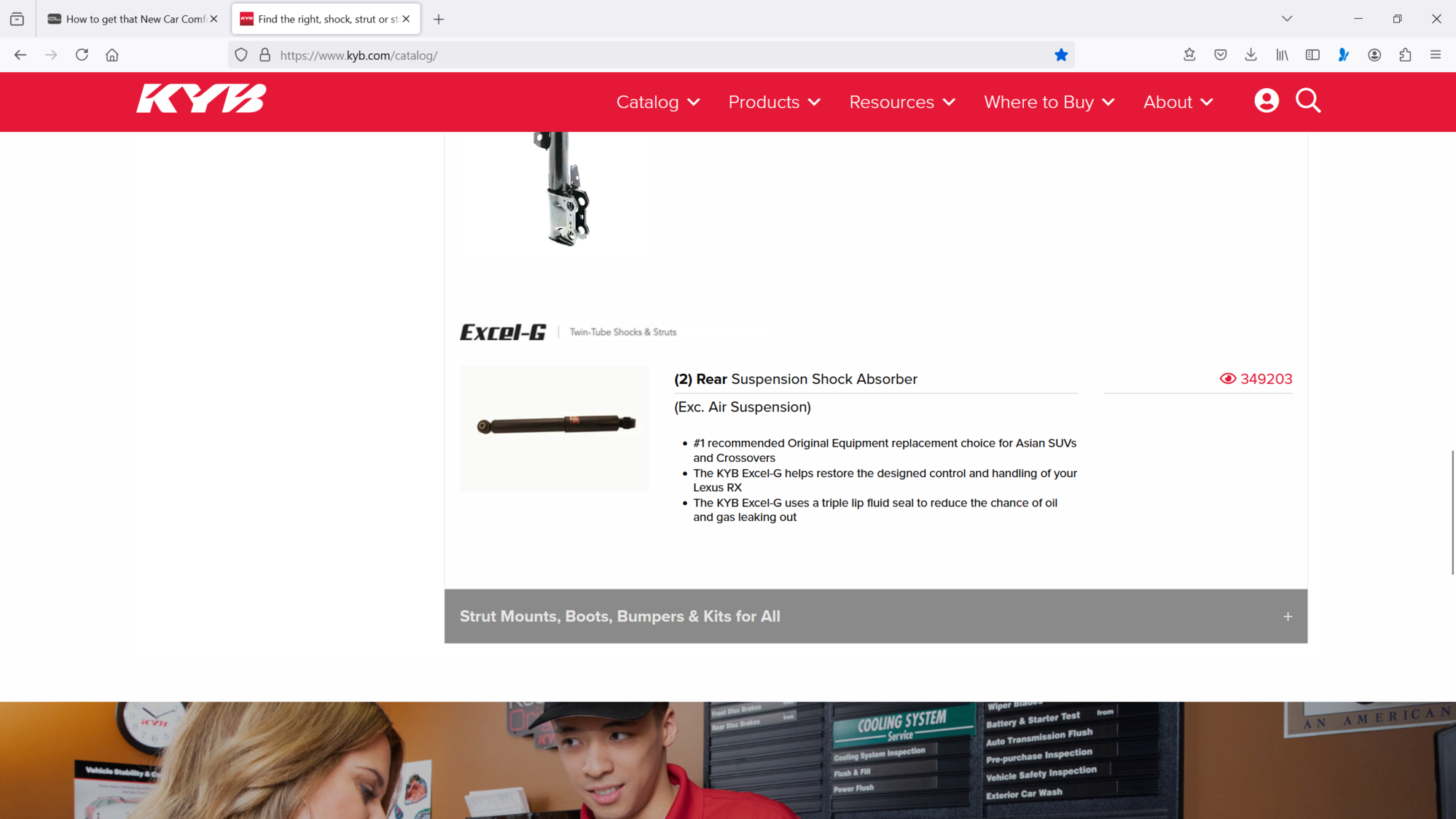

I am personally going to change out the front struts and rear shocks on my 2015 Rx350 AWD with the KYB gas strut/shock brand. I was going to go with the Bilstein brand, but they do not make a quick strut(complete unit with preinstalled spring) for the front struts on my RX350. I do not want to deal with a spring compressor to install my old front coil spring on my new struts. The KYB units are just a simple bolt-on swap and are good performing gas charged units as well.
The KYB ride stiffness is a bit more than the stock base model and maybe less than the Bilstein B6 performance version I believe.
Bilsteins B6 shocks are my first choice if I really need to improve my rides performance, but I have had good results with KYB as well. I thought about mix and matching the KYB front quick struts with Bilstein B6 rear shocks on my RX350, but just decided to use a matching KYB set to prevent any weird handling in my RX350.

I had great success with KYB quick struts on my 2008 ES, ride height is not higher, ride is not harsher. ride is perfect! You can email KYB and ask them what specs they design them to. They are experts at this. Here is my account of using KYB's and also rebuilding entire suspension, which is holding up nicely. https://www.clublexus.com/forums/es-...y-options.html

I replaced 4 KYB shocks . As I wrote above, the front spring is thinner. Low arms. sway bar links .wheel alignment 18 wheel . It rides well but on small bumps car jumps and does not smooth out the impacts. I have second RX with orig front shocks 170 000km not a big difference to drive.

Yes, the aftermarket quick-strut springs are maybe stiffer to account for worm bushings and other aged suspension parts to help improve an older car's ride, but that do not mean the springs are of lesser quality.
My discussions with KYB concerning the 2008 ES confirm that KYB designs everything to factory specifications. KYB does not account for a worn suspension - that would be an impossible mission, as each level of wear is different. Worn suspensions SHOULD be fixed while installing new struts, however, many of the posts I see on these boards do not address their worn suspensions, they simply replace their struts. If you have 150K miles on your car, you have a worn suspension. Like it or not. I could not tell you if KYB designs 3rd GEN RX to factory, I haven't asked them. YET.

I am not sure it was KYB or not, but one of the suspension companies stated in a product video that their strut/shock products are designed to account for other worn suspension parts to still give near factory ride and control on older cars. Make sense to tweak the shocks/struts a bit since new struts/shocks alone will not improve a older car performance or control to how it was when new.
Either way, I will just install the KYB shock/struts and new control arms, tie rods ends, and sway bay links in my RX350. I actually prefer a stiffer more controlled ride over soft suspensions, so if the KYB ride is stiffer than I will good with it.

Just email KYB and ask them, then you will know. They answer pretty quick. https://www.kyb.com/contact/technical-support/
