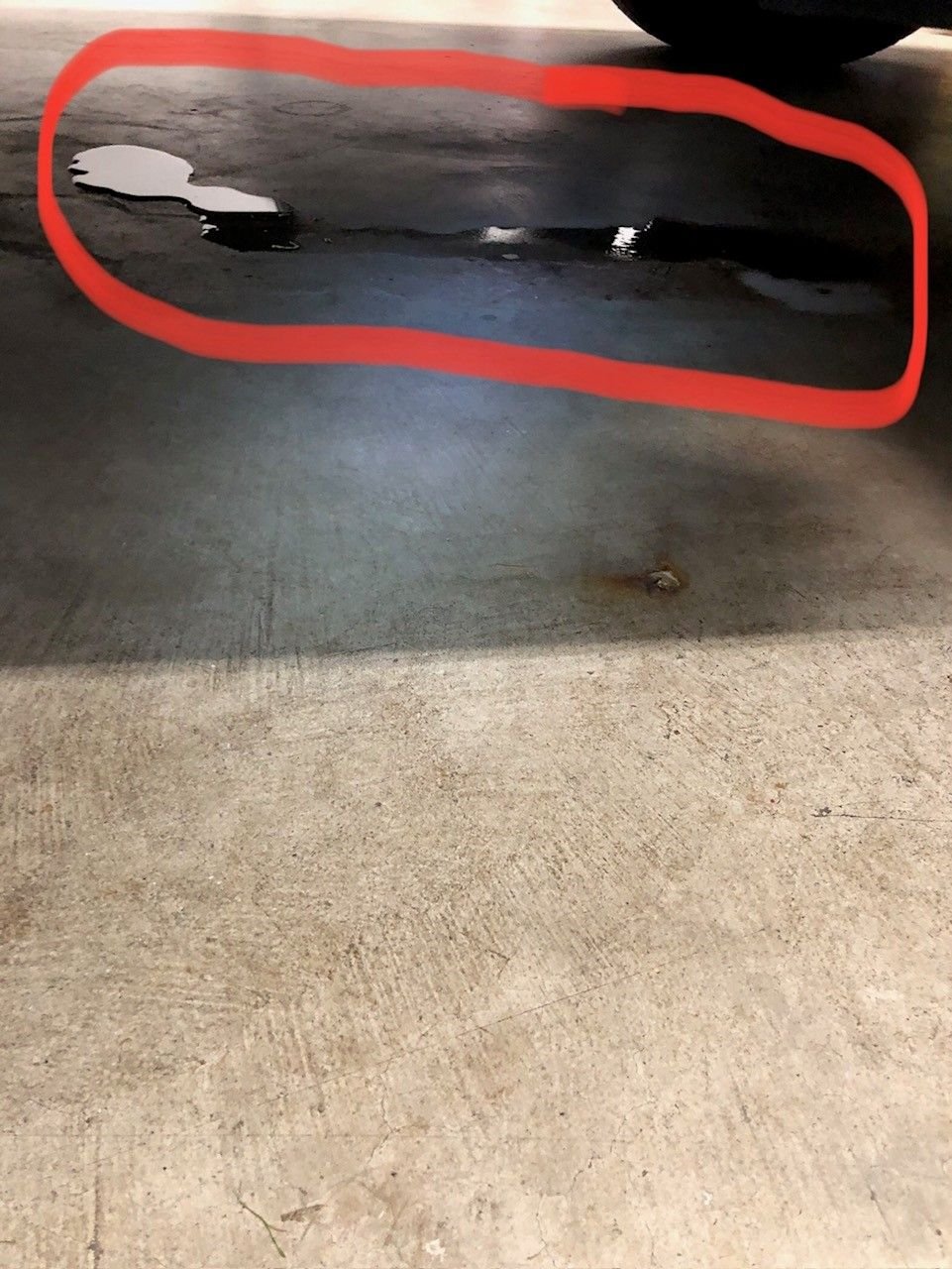

Hi Everyone. I noticed an excessive amount of water coming from the a/c compressor drip this evening and it feels oily to the touch. The fluid is still clear. Has anyone else experienced this? 2015 Rx350. Thanks.

I are the puddles evaporating completely or is there some oil building up? Is probably nothing to worry about, the condensation is coming from the evaporator that’s buried in the dash, I guess if it has a leak you would get some PAG oil in the condensation, but pretty soon your refrigerant level would drop and the compressor would stop running. As long as there is condensation u set the car, everything is still working properly.

I checked this morning and it all fully evaporated. Thanks.
