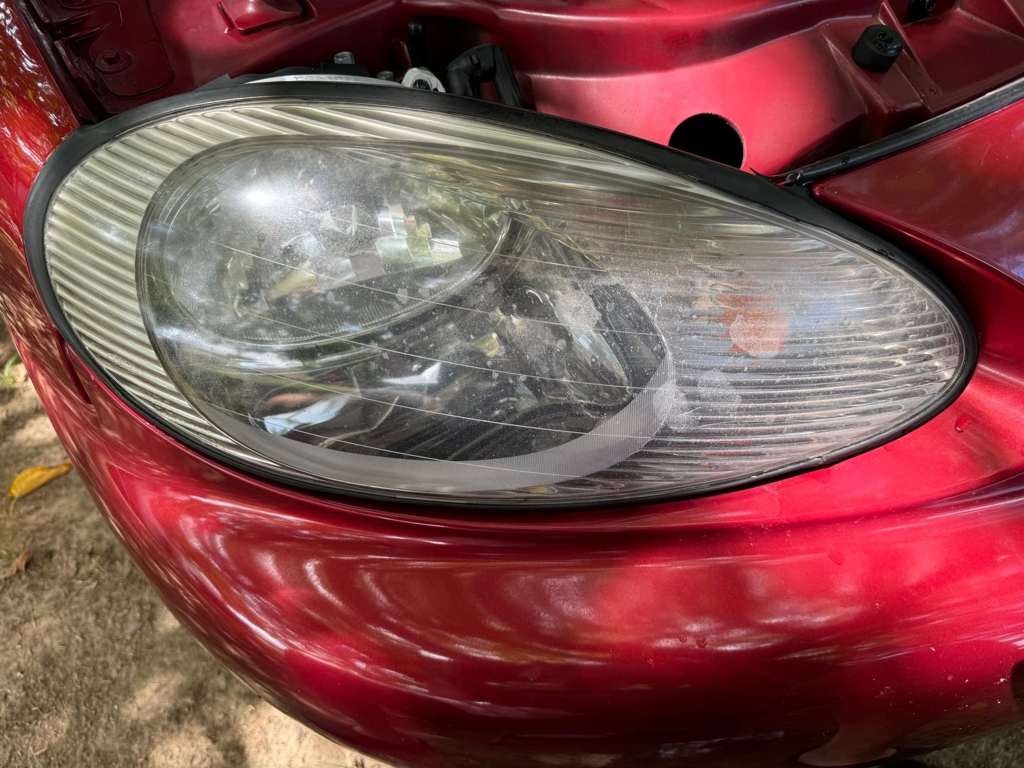

A friend just told me about this headlight restoration kit which is easier to use than most and provides a final ceramic coat with claimed permanent UV protection, all for under $20. He is testing it today on a 1996 Mercury Sable Wagon (don't laugh) and I will report on the results soon.
https://cerakoteceramics.com/cerakot...storation-kit/

These are before and after photos of the 1996 Mercury Sable headlights after using the CERAKOTE® Ceramic Headlight Restoration Kit. My friend picked it up at an estate sale for a great price. One owner, 55,000 miles, garage kept and all service records from the Ford dealer since it was new.
