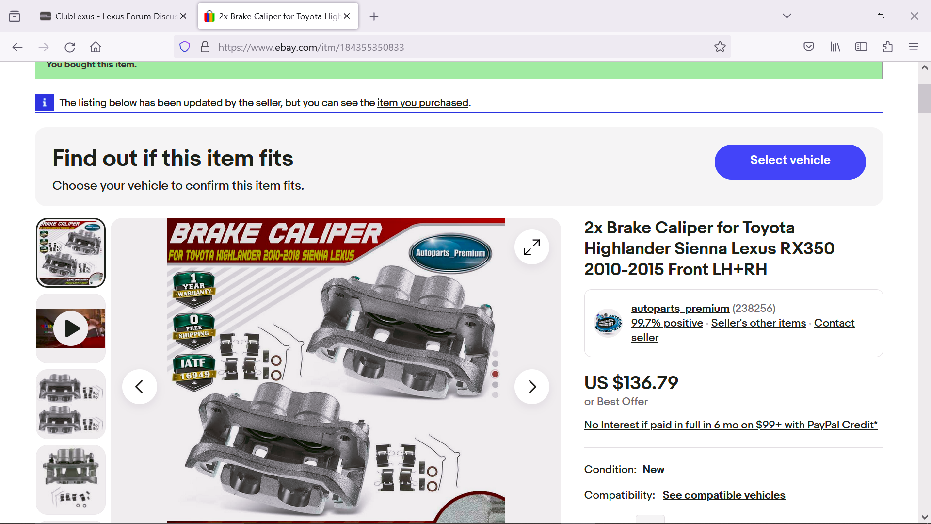

I chose the generic calipers since they are simple devices that only need a good seal and freely sliding pistons to work properly. No need to spend a lot of money on them unless upgrading in size. The key is to buy coated(painted) ones to prevent rusting.
My fronts I ordered. The painted calipers and coated rotors still look and performs good a year later. The whole set cost a fraction of what new Lexus calipers and rotors would cost.
