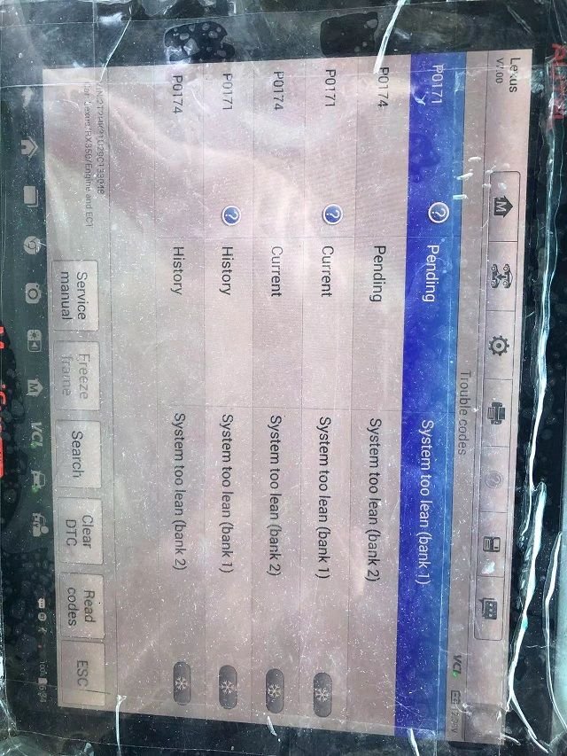

2009 RX350
Trouble code P0171&P0174
I used another vehicle(toyota sienna)'s mass air flow sensor to replace my car's mass air flow sensor, but it did not work. Through the similar method, I replaced the oxygen sensor, B1S1 & B2S1, but it did not work either. And no air leak was found after I checked. The long FT was still high. I have no idea about the problem.
the trouble code:

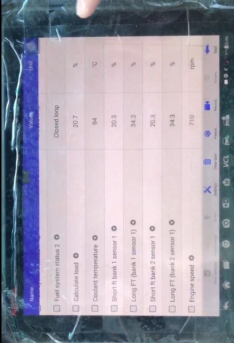

700 rpm mass air flow:
700 rpm short FT & long FT:
1800 rpm mass air flow:
1800 rpm short FT & long FT:

2009 RX350
trouble code P0171&P0174
I used another vehicle's mass air flow sensor to replace my car's mass air flow sensor. And through a similar method, I replace the B1S1&B2S1. but the long FT was still high. I have no idea about the problem.
trouble code:

Looking at your fuel trums at idle at approx 50% for each bank is very high and suggests a tear in the rubber air tubes on the throttle body drawing massive unmetered air.
Recommend pulling both rubber tubes and inspecting for cracks or not being installed properly.
If the leak is not found here, can look around because it's sucking ar somewhere.
Also noticed your fuel trims improved to approx 35% for each bank with raised idle and this is again confirmation of a massive vacuum leak.
I think you have 2 problems, massive vacuum leak and bad MAF sensor.
