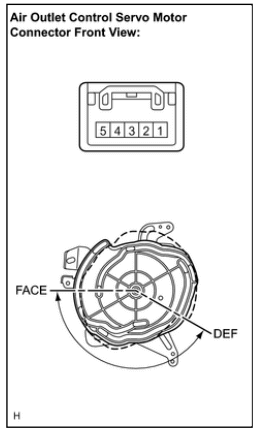

Testing:
Quote"
a) Remove the air outlet control servo motor.
b) Connect the positive (+) lead from the battery to terminal 4 and negative (-) lead to terminal 5, then check that
the lever turns to "DEF" position.
(c) Connect the positive (+) lead from the battery to terminal 5 and negative (-) lead to terminal 4, then check that
the lever turns to "FACE" position."
Anyone else have a Spazzing and noisy servo like me?

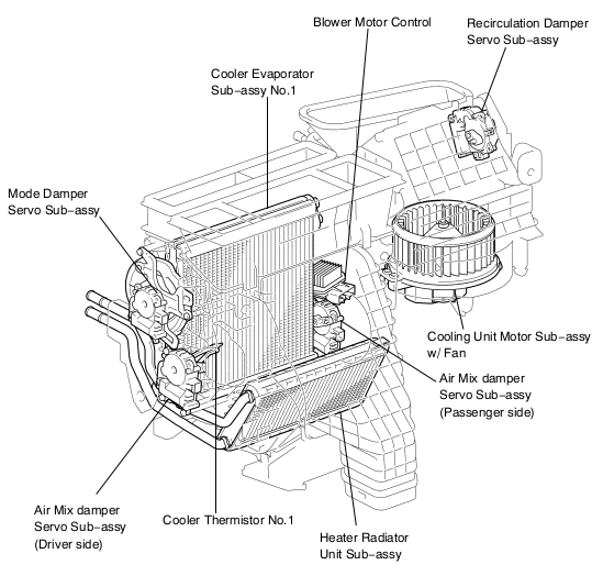

>> Below- the "Mode Servo" is the one we are interested in for anyone following along.
> Air mix servo on driver side is also accessed in the same way and sufferes the same fate.

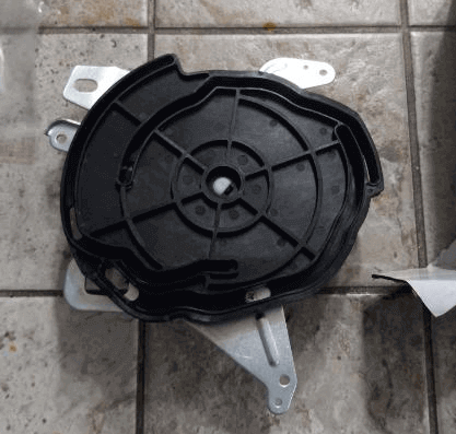

Pics of removal would be awesome.
I dug this out of my storage tote in the shed today.
Honestly, since it was a year or so ago when I had the plastic cover off I can't remember exactly what the old servo unit looks like.
Today is the first time I opened my fleabay replacement servo to take a look and took some pics for everyone.
Please let me know if this is what you are seeing up in there since I have not tested for fitment yet.
AND- this generic POS came in a white box with no writing on it but had a part# on a small white sticker- the actual unit has no brand or markings on it- totally generic. lol
