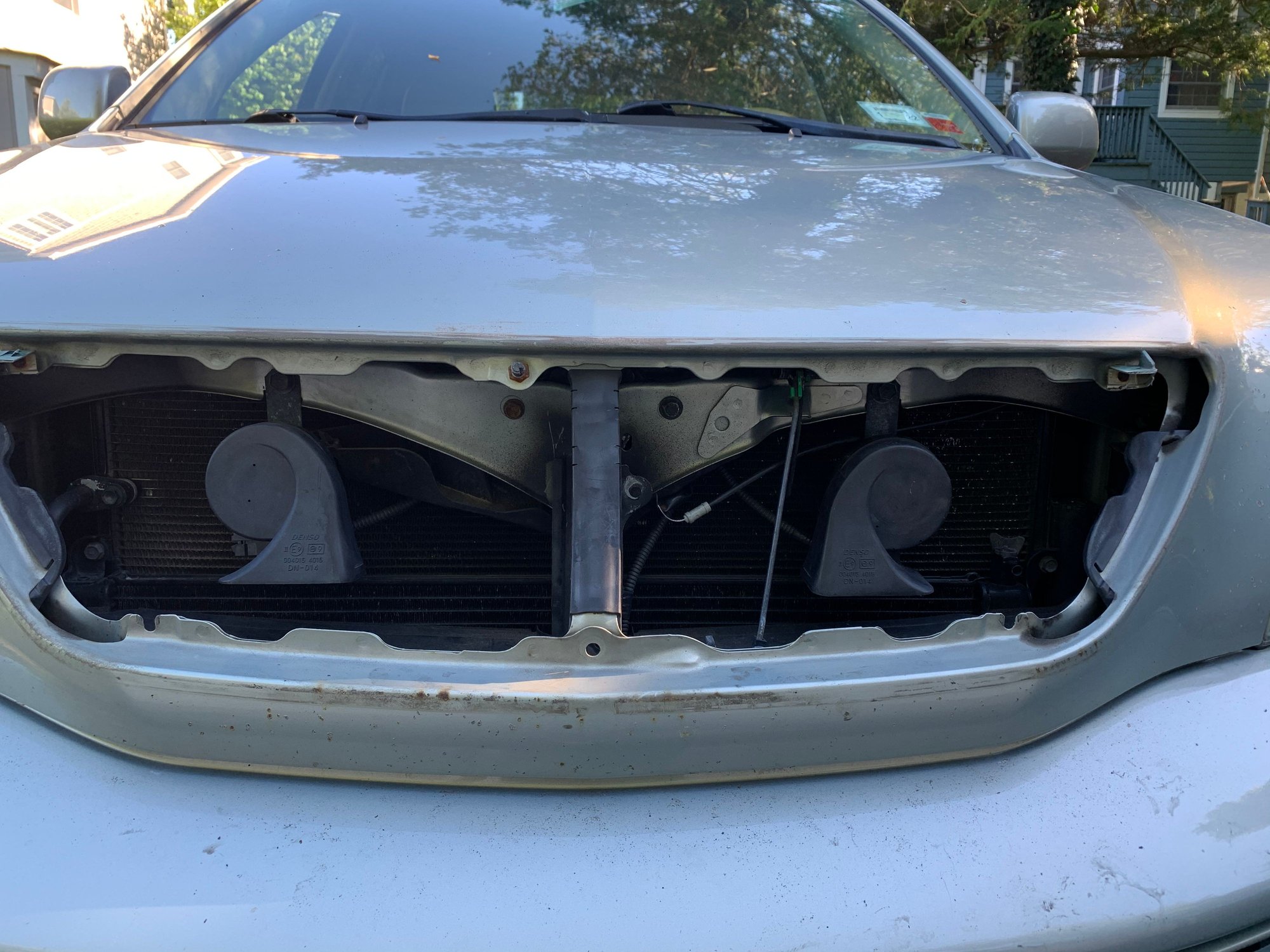

Here is a picture. Got the grill off and it looks like the cable is broken off of the latch. I pull but nothing happens. I can’t seem to find the lock release.

Yah, now see the video I linked. In the end he unbolts the latch and it comes up attached to hood and you can then get it off. If that doesn't work, then you should be able to pull on it where that cable goes into the latch.

Of course Lexus makes things more difficult. Saw the video. The difference with the RX is that you cannot remove the latch as it covered my a metal support that attached with 6 bolts. Loosening the 3 bolts on the latch won’t do much. In the picture you can see the cable. Problem is it’s detached from the latch and the attachment point is buried behind the non removable latch.
anyone have a diagram of the lock mechanism?

Yah, the lock carrier is on top of latch on mine too. I bet that strip of steel is pretty cheap, as last resort I'd just cut the thing to get the latch free, and go to junkyard and get a new top carrier piece.

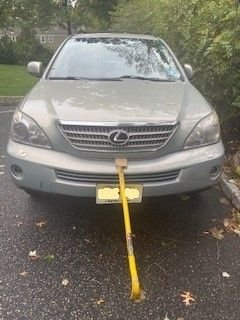

take a heavy pry bar and stick it under the bottom edge of the front of the hood directly dead center and let it hang. If you don’t have one long and heavy enough get someone to apply pressure and then pull the cable with pliers.
My hood wouldn’t open for a couple days and I had a long enough pry bar. I could have had my fiancé help if i didn’t but as soon as I pulled the latch the hood popped then I blasted the latch with lubricant penetrant/ wd40 and it never happened again.

it sounds as though you didn’t quite do what I instructed since you said you physically exerted effort on the pry bar.
you need to put the pry bar in the slot between the hood/ grille and the bumper directly dead center and let it hang if it’s heavy enough to exert pressure on the hood then pull the latch cable.
I luckily had a long crowbar that weighed 3 pounds so it applied enough force while hanging there so I could pull the latch and the hood finally popped. But if it isn’t heavy enough to apply the force you’re going to need someone to apply just a little force, not so much whereas you feel the hood is going to brake.
you might have damaged the latch by drilling into it and this might not work because of that. However if this doesn’t work then the best thing to do is go under the car, remove the protective plastic splash hairs under the radiator and condenser and then use a pry bar to reach up and hit the release mechanism then the hood will open. Drilling into it isn’t the best way to go.
but it sounds like you didn’t do exactly what I instructed. You just need a little bit of pressure applied against the latch and then use pliers to pull the latch cable from inside the vehicle since it’s disconnected from the latch.
if my pry bar trick doesn’t work you likely need to replace the latch and or cable. Good luck
the goal of what I recommended is to pull the cable while pressure is being applied to the hood/ latch mechanism. If it’s rusted frozen this will force it open.

Here is the set up:
That pry bar is at least 5 lbs. maybe more. I also put pressure on it while a helper pulled the cable to the point I was worried about breaking the hood. I can hear the cable moving but it’s just not doing anything.
Any other thoughts? Do I break the grill? That’s an expensive way to go. Would I even be able to open the hood if I did??
