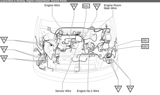

Just saw your update did your old codes P0121, P0123, and PP2135 go away or is the Cam code added to this now?
If so nad1370 nailed it. There is an overlap in the circuit thru splices to throttle position and towards ECM. Plz consider detail below.
Here are some ECM Ground Points that may be loose located at ED and EE.

Originally Posted by Nad1370
9/10 times after doing a tune-up on these, the Cam sensor connector wires will get stretched if not unplugged.
Please take a closer look at that before deeming the sensor bad.
These sensors are pretty robust.
Thank you both for the reply. Very helpful (the schematics!). Compromised wiring makes the most sense, but I can't discount a faulty sensor which could have triggered VSC warning light and code P0355 in the first place.

I installed new camshaft sensor at Sensor "B", Bank 1 [part #90919-T5005], cleared ECU, and tried restarting but she continues to do the same thing... turn on for about 2-3 seconds then stalls!
The good news (I suppose) is that OBD scan is no longer detecting any fault codes! I'm going to let her sit over night and try it again in the morning.
One thing I'm noticing now is a real strong smell of gas fumes.
Just to reiterate, all I did was disconnect air box, throttle body, cleaned throttle body, disconnected plenum and vacuum hoses, disconnected coil packs, removed spark plugs, disconnected and removed camshaft sensor B on bank 1, and then reconnected everything back to the way it was. I took my time and was very careful. Short of putting the old spark plugs/ coil packs back in, I've disconnected and reconnected everything, and double checked everything, at least a dozen times now.
When it turns over and is on for a few seconds, it purrs like a kitten and sounds great. But it just won't stay on, and now it there's a strong odor of gas fumes to the point that I have to leave the garage.
Please let me know if anyone has any other ideas.
