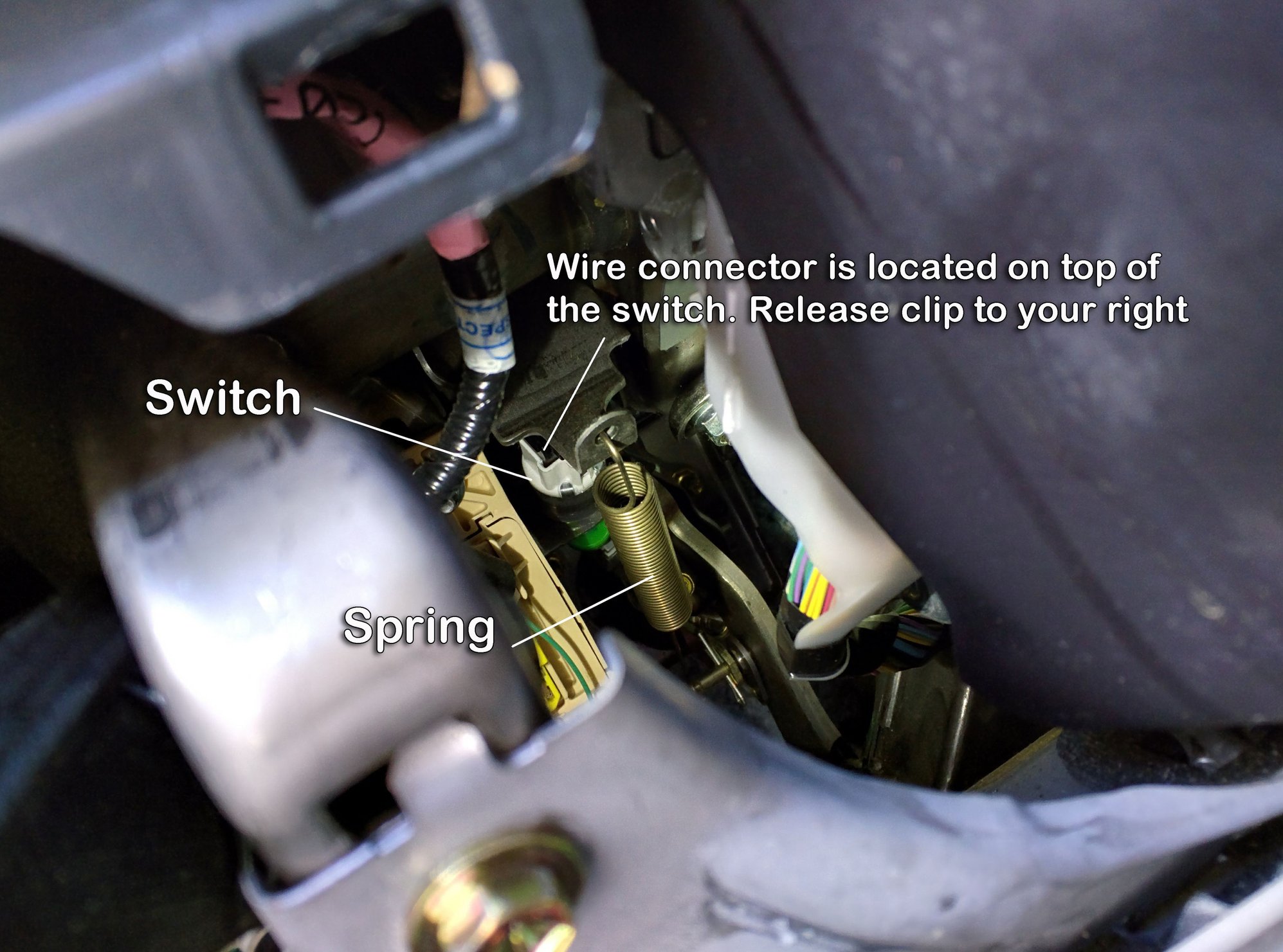

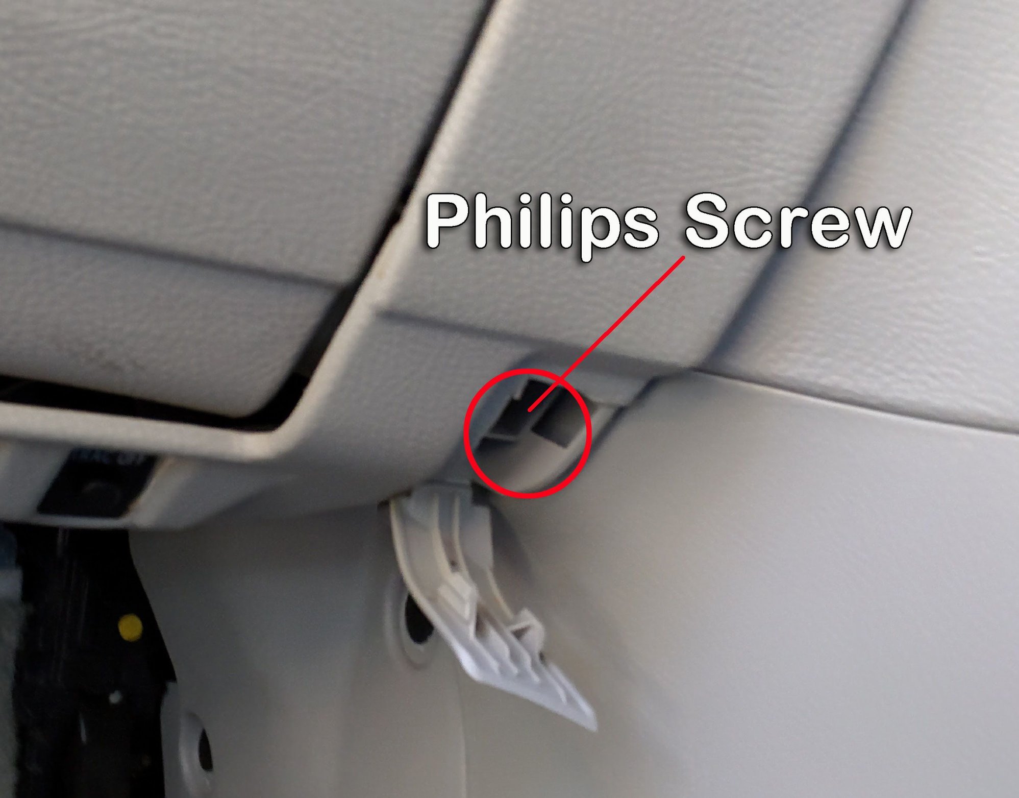

My 05 RX330 had the same issue. Ordered a genuine Toyota / Lexus part# 84340-20060 (newest replacement number from Lexus). You need a 10mm socket for the dash panel, a Philips screw driver, and a 14mm 'short' wrench to loosen the nut holding the original switch in place. Took 20 minutes prep, 5 minutes to replace, $40 for the part off eBay. I only had a single test drive, but so far, so good.
Start by gently peeling back the trim by the drivers door, just under the dash. Remove the 10mm bolt.
Pull back on the right side of the lower dash trim and undo the screw. This will release the lower dash section under your steering wheel.
GENTLY pull the dash towards you. I left the 9 zillion wires attached, and the plastic just hung on during the repair.

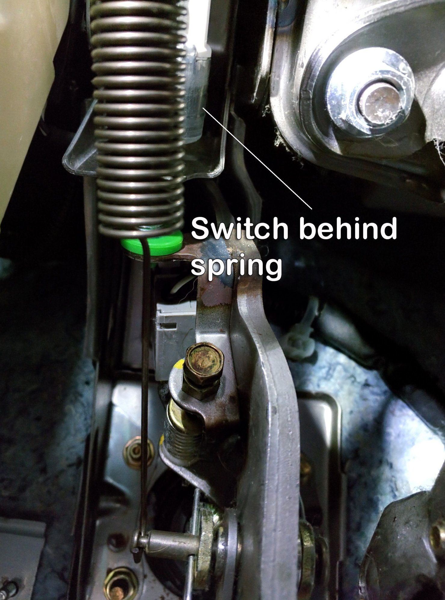

The switch is hard to locate, and difficult to see. Look for a 3" spring, which I unhooked to gain access to the switch.
Unclip the harness at the top of the brake switch. Use a short 14mm wrench to loosen the switch, then spin the assembly out.
Install the new switch, with the adjustment nut in the same place as the original. Test your brake lights. Remember to replace the spring before you close up the dash.
All done. $40 and 25 minutes. I'm a happy Lexus fanboy!
