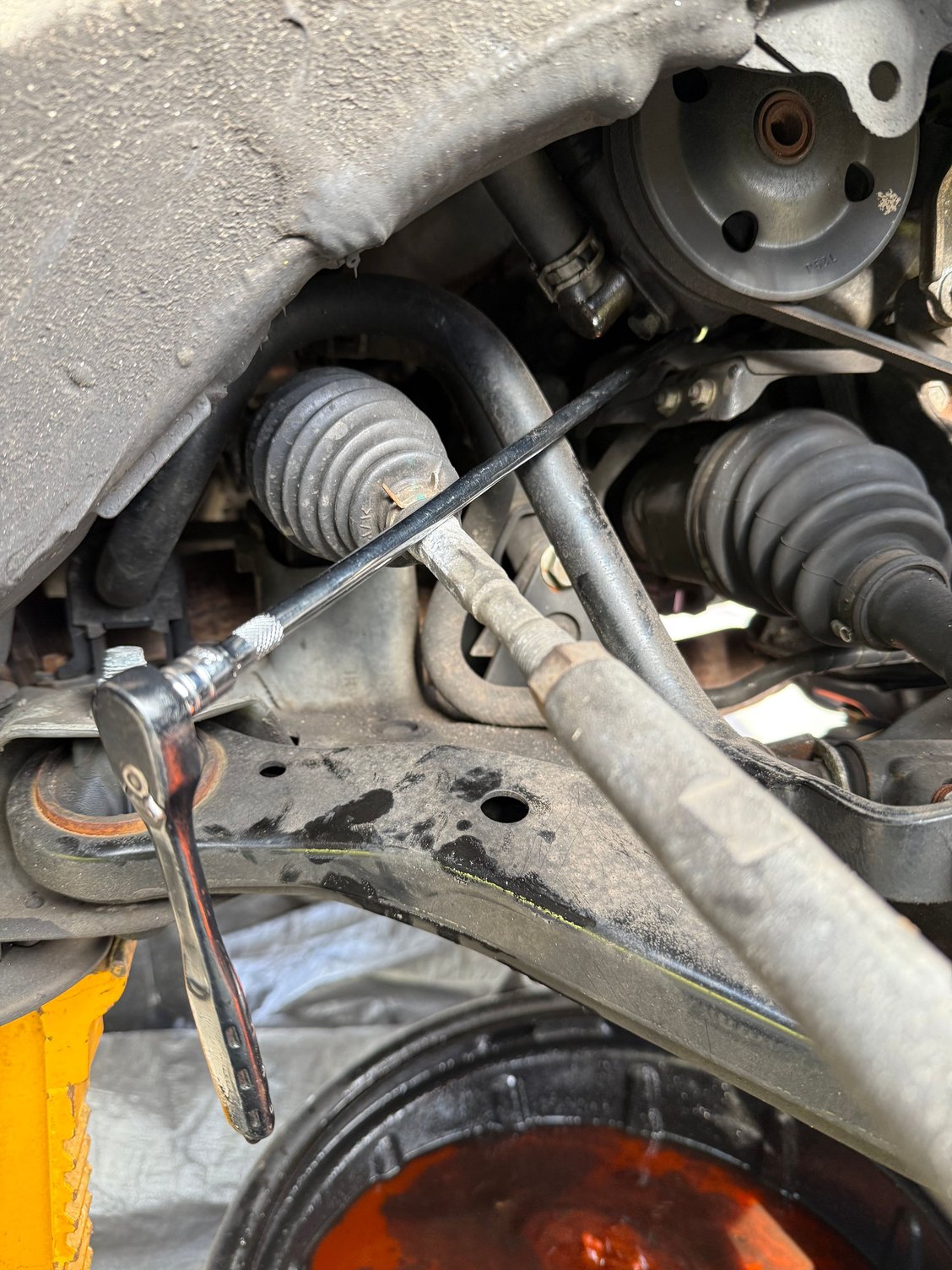

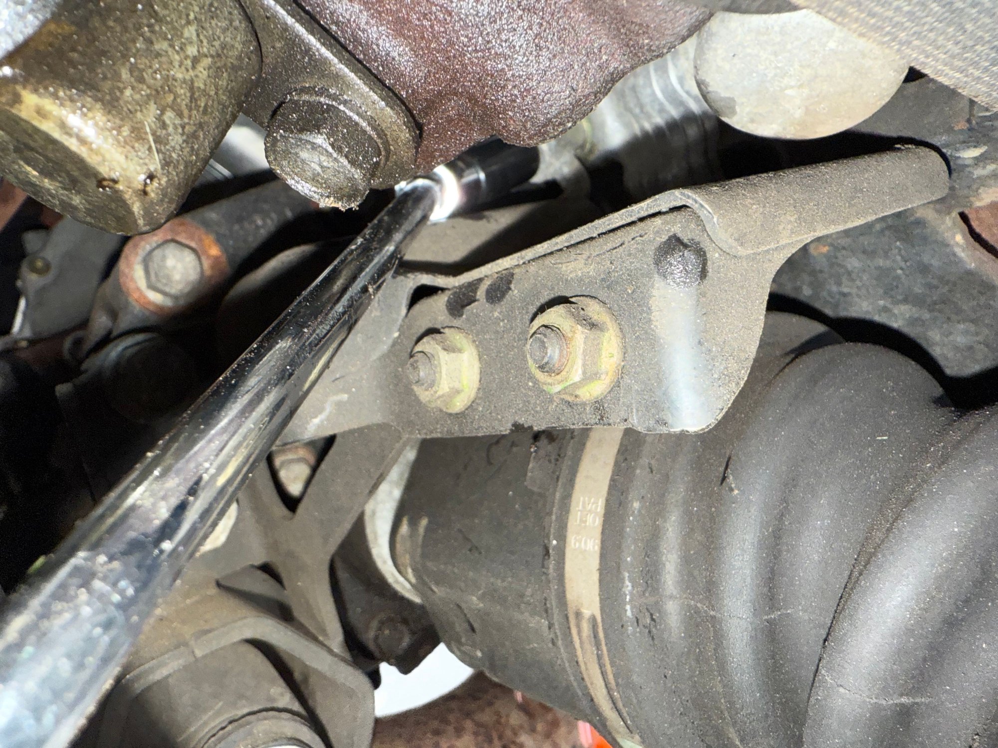

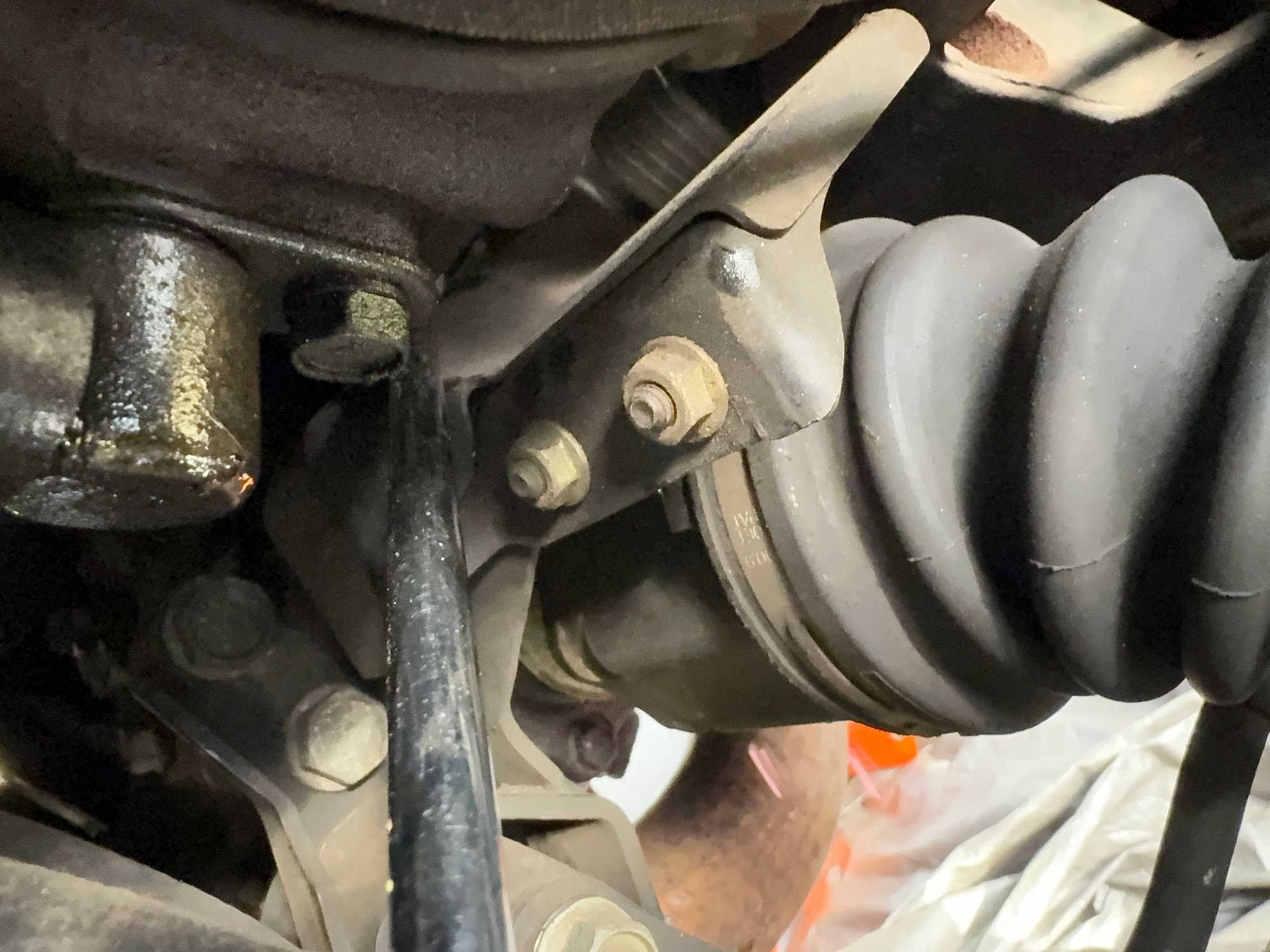

For the rear block plug….1/4” universal adapter. 10mm socket. 6”-10” extension. Take off tire and go in thru here
