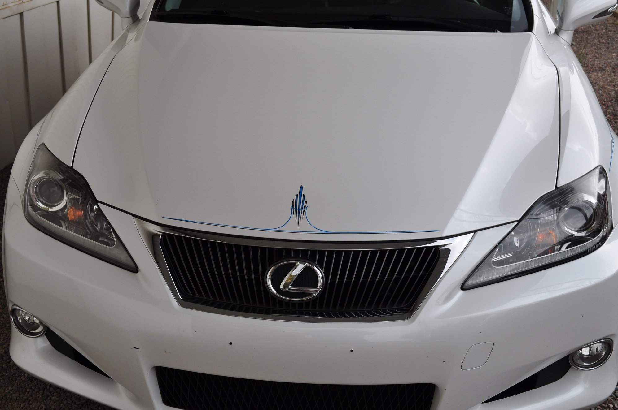

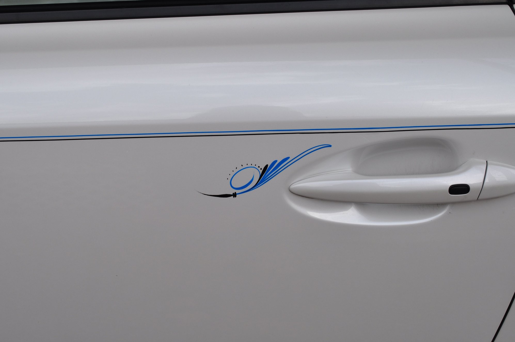

Yeah, I wouldn't use paint stripper. If the stripes are plastic, then either the heat gun or decal remover will work without hurting the base paint. If the stripes are an enamal, then lacquer thinner will usually take it all off w/o harm to factory paint.
When mine had some sections that flaked off, I had a sign shop pinstripe over the bad sections and you can't tell at all. You can also have the pinstriper add to what's there to make it a decoration you like. I'll post some photos if I can make it work.
