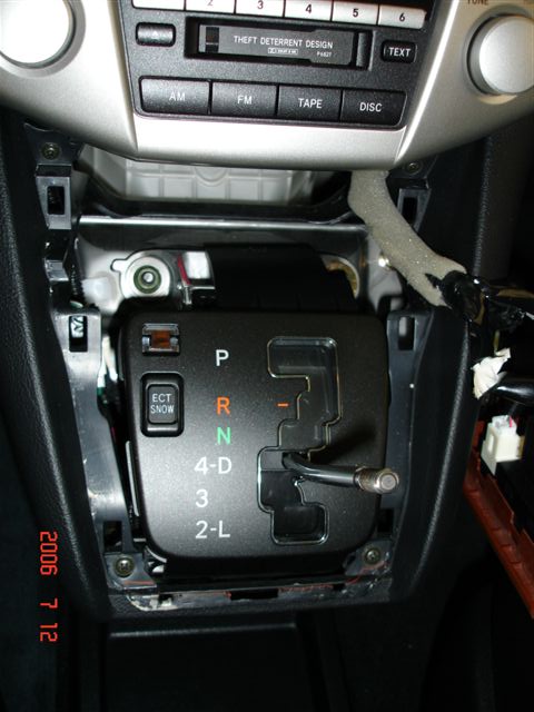

Step 3: REMOVE THE TAB AND PRESS THE INSIDE BUTTON TO SHIFT THE **** TO 'D' or ‘L’ (to get the shift **** out of the way) - The tab on the upper left of the shifter gate can be removed with a small flathead.
Step 4: PULL OFF THE WOOD SHIFTER GATE TRIM – Put both hands at the bottom of wood trim and pull upwards evenly on the left/right. It takes a little bit of force, but eventually the bottom part will come up, and then gently pull the top part off. This piece of trim is held on only by 4 clips.
Step 5: PULL OFF THE CIG LIGHTER WOOD TRIM PIECE – Put one hand behind the left side of the wood trim and the other hand behind the wood trim on the right. Pull evenly towards your body (pull straight out) and the piece will give and come out. This piece of trim is held on only by 2 clips. You do not have to unplug the wires on this piece; you can just let the thing dangle off the side.

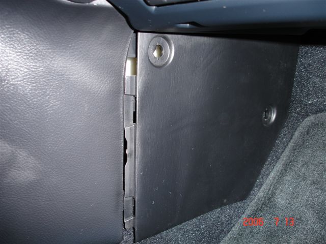

Step 11: REMOVE THE PASSENGER FOOTWELL SIDE PANEL – On the 04 RX there are 2 small plastic tab screws that you unscrew and remove. (On the 06+ RX they are not screws but just plastic punch tabs which you pry off with flathead.) The panel is held in by clips on the left hand side. Slide the panel to the RIGHT to unhook the tabs carefully. Note: Do not just pull the panel straight towards you – you can crack the tabs, as they are thin and fragile.

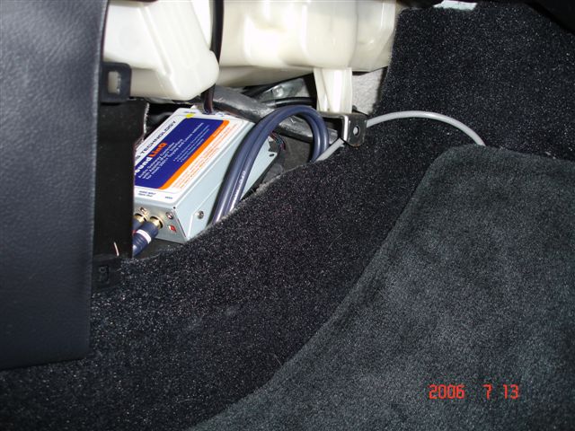

Step 12: FEED VAIS CABLE INTO THE LOWER CAVITY AREA – Take the straight Vais cable that you just connected to the Y cable and feed it down thru the cavity towards the passenger footwell. It takes a little bit of fiddling, but it will get down there with plenty of slack to spare. Make sure you pull the slack down by the passenger area so it is easier to replace the RA when you are complete.

Step 12: CONNECT SLI and IPOD – Take the white Vais plug that you just fed into the passenger footwell and connect it to the SLI. Connect the last Vais cable (the gray plug w/ RCA) to the IPOD and SLI as instructed in the manual.

Step 15: VELCRO SLI and CLOSE SIDE PANEL – Velcro 2 strips to the bottom of the SLI and place the SLI snugly inside that bottom area by the passenger footwell. Leave the gray wire out anywhere you want it to come out. Replace the side panel.
MultiTasking Mom
Step 16: TUCK/HIDE GRAY WIRE – You can either tuck the gray wire along the center stack or hide it under the mat. I chose the floor mat hide. I taped up the last 8” or so with black electrical tape since I have the black interior and the wire basically is exposed by the edge of the floormat next to the tray. My iPod sits in the tray on a sticky pad.

- I mainly use the iPod to connect and disconnect when I get into the car. I don't use it in simple mode, so I don't need much slack to control the iPod directly. If you prefer direct control, I recommend doing the gray wire tuck along the bottom of the center stack. That will give you at least a foot more slack in the wire to be able to pick up the iPod from the tray.
- The iPod location does not interfere with the sliding center console. You can still slide back and forward in every position.
- The SLI is accessible within 30 sec once you remove the side panel. There is no reason to undo all the wood trim and Radio assembly to get to the SLI in the event you need an upgrade in the future.
