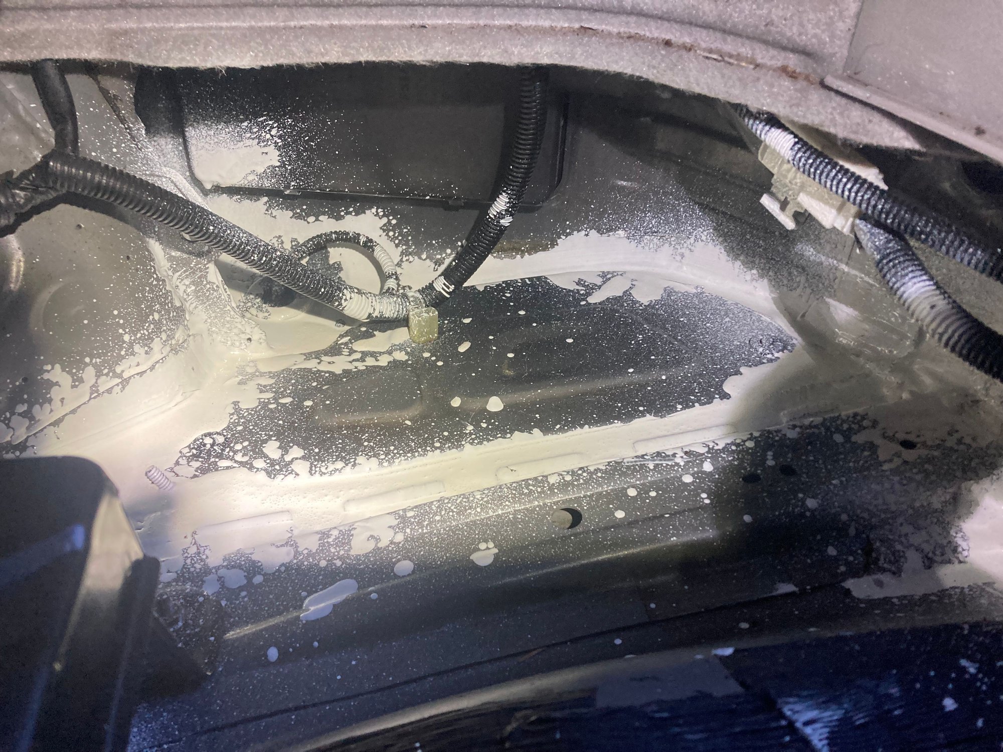

Anything that comes in through the roof drops on the headliner. You can pull it down easily yourself in the rear and look to convince yourself. If the headliner is not wet, the leak is not from the roof in any way. it is a thin sheet metal roof and nothing between it and the headliner (one of the reasons the car is so damn loud inside, of course).
What did you do in this area, I’m not following exactly? ( I added extra white spray seam sealant as a jic, don’t be confused). These things leak like sieves over time so this is a common issue people fight. There’s a parallel thread on this right now.
anything that gets in here goes forward, you blocked it somehow? Or it got wet in here?

What area exactly is your photo?
I put sealant on both weld areas above the hinges on both sides of the back hatch, and the weld areas below that. I'll share pics tomorrow

Old Dec 9, 2025 | 11:04 PM
Oro's Avatar
Oro
Joined: Dec 2013
Posts: 3,466
Likes: 920
From: wa
That’s the trunk well.
You have not removed the rear package trays and looked in the trunk well? Because that is #1 source of leaks that end up in foot wells, if not front sunroof drains (another common leak point).

Trunk photos - Wed. Dec.10
