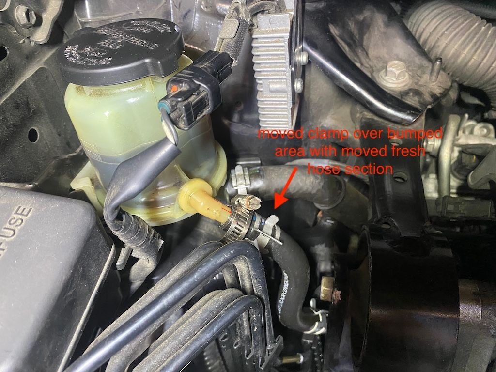

Was able to fix the reservoir leak without replacing the hose. Just pull out slightly to get fresh rubber on the bump on the fitting. Move clamp over this bump and added a 2nd clamp (probably not doing anything to help seal) 1 month / 500 miles later no leak.
Also previously exchanged 600mL of PS fluid with synth Dex3 ATF + a little Lucas leak stop and seems to have stopped the prior leak. Still full at max hot like before at 1mo 500 mile follow up.
