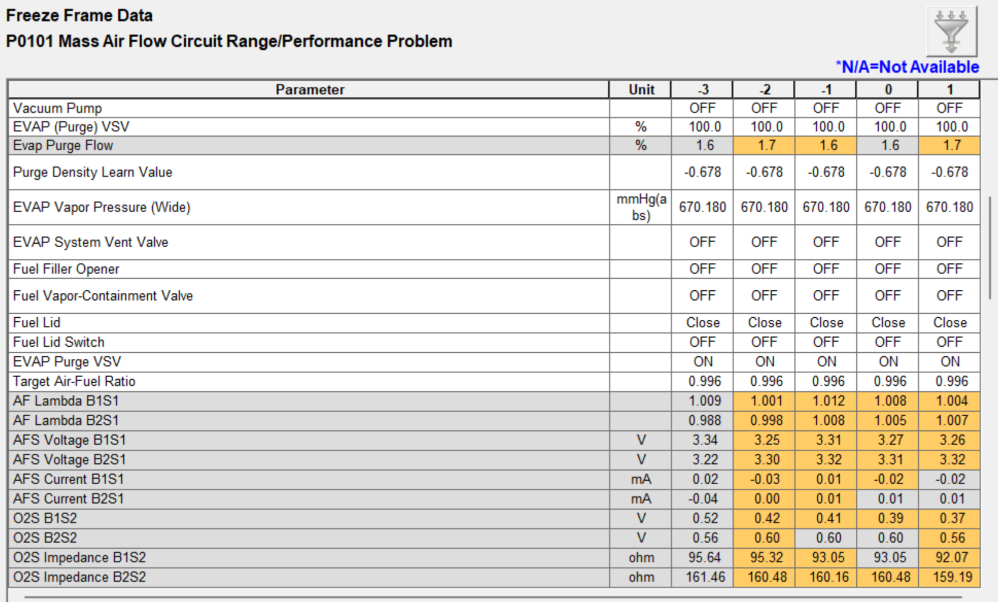

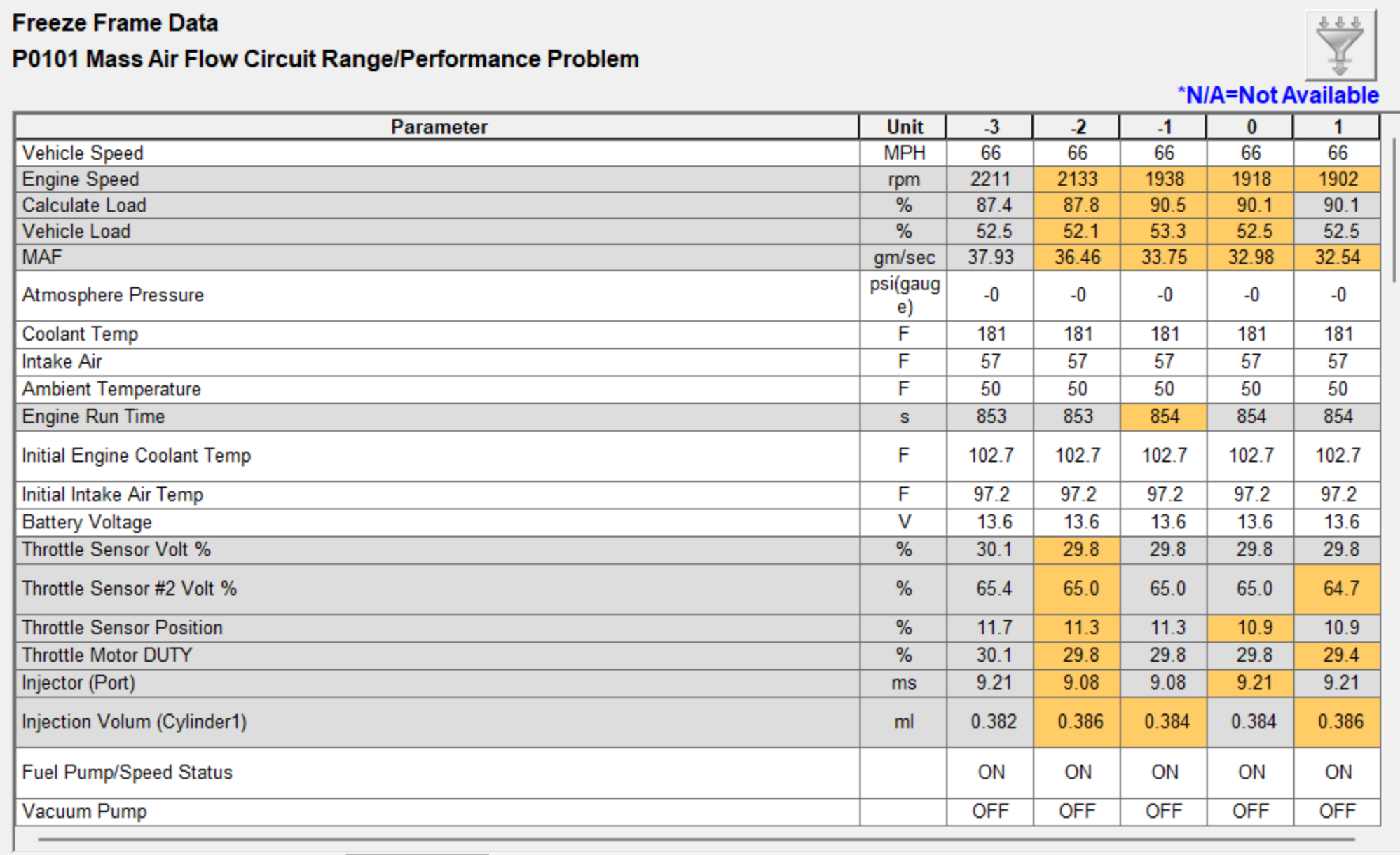

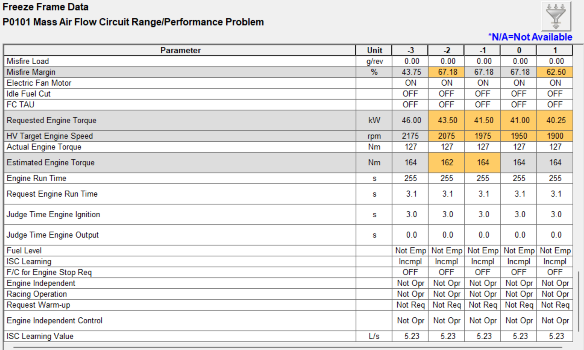

On my 2008 RX 400h with 195K miles -- both times right after heavy acceleration (100 kW+) and going uphill on the highway, I got a check engine light that seems innocuous.
I don't really notice any issues driving the car, and both times it clears up by itself after 3-4 trips.
I pulled up my handy Techstream to get detailed data on systems at the time when the light came out, attached below. I think the data is cool. What do y'all think could be the cause? Should I try to replace any components? Or leave it be since it's quite rare?

Lot of data there, but the LTFT is about maxed out. I would research to see if that relates to the MAF, or is a simple vacuum/manifold leak?
Old Apr 14, 2025 | 08:08 AM
Leeper's Avatar
Leeper
Joined: Aug 2023
Posts: 895
Likes: 433
From: ID
Start with routine maintenance. I'd suggest:
#1 - replace your vent lines (total cost likely under $20. I have 170K miles on mine my lines were badly cracked. Got mine at Autozone
#2 - remove the MAF spray it with some MAF clkeanrer (never use any other cleaner and never touch the element). Spray can be found at Walmart cheaply
#3 - While there wipe out the throttle body and inlet with brake cleaner
All that takes maybe an hour with very basic tools and limited mechanical knowledge
After cleaning MAF and Throttle boddy disconnect your battery for a couple mins then reconnect (yes you'll have to do a window, sunroof and tailgate reset) this resets your ECM. Your car will take maybe 50 miles to relearn your driving technique. After all that recheck your engine values on Techstream
