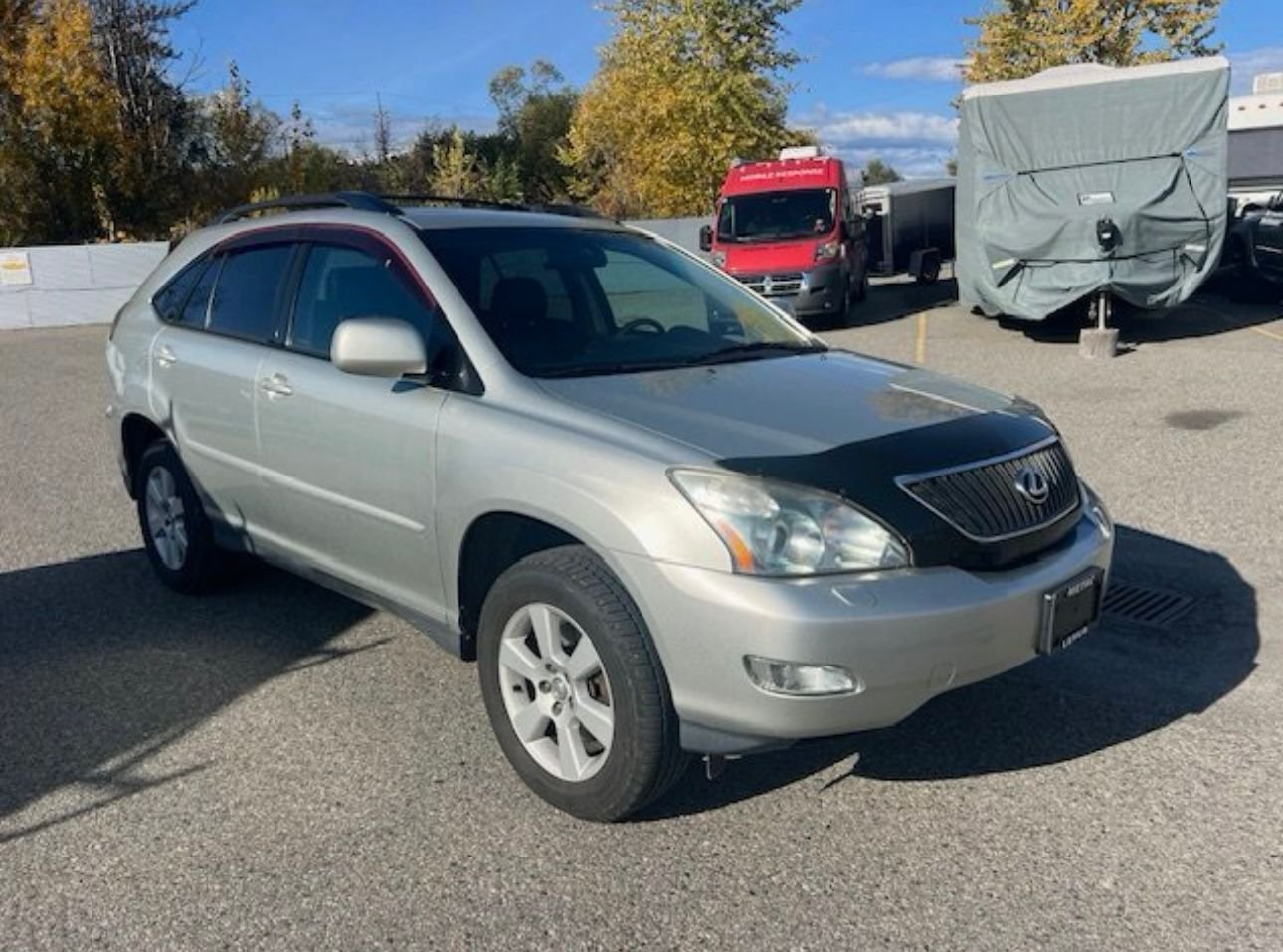

I stumbled across this listed by an auctioneer (representing a client).

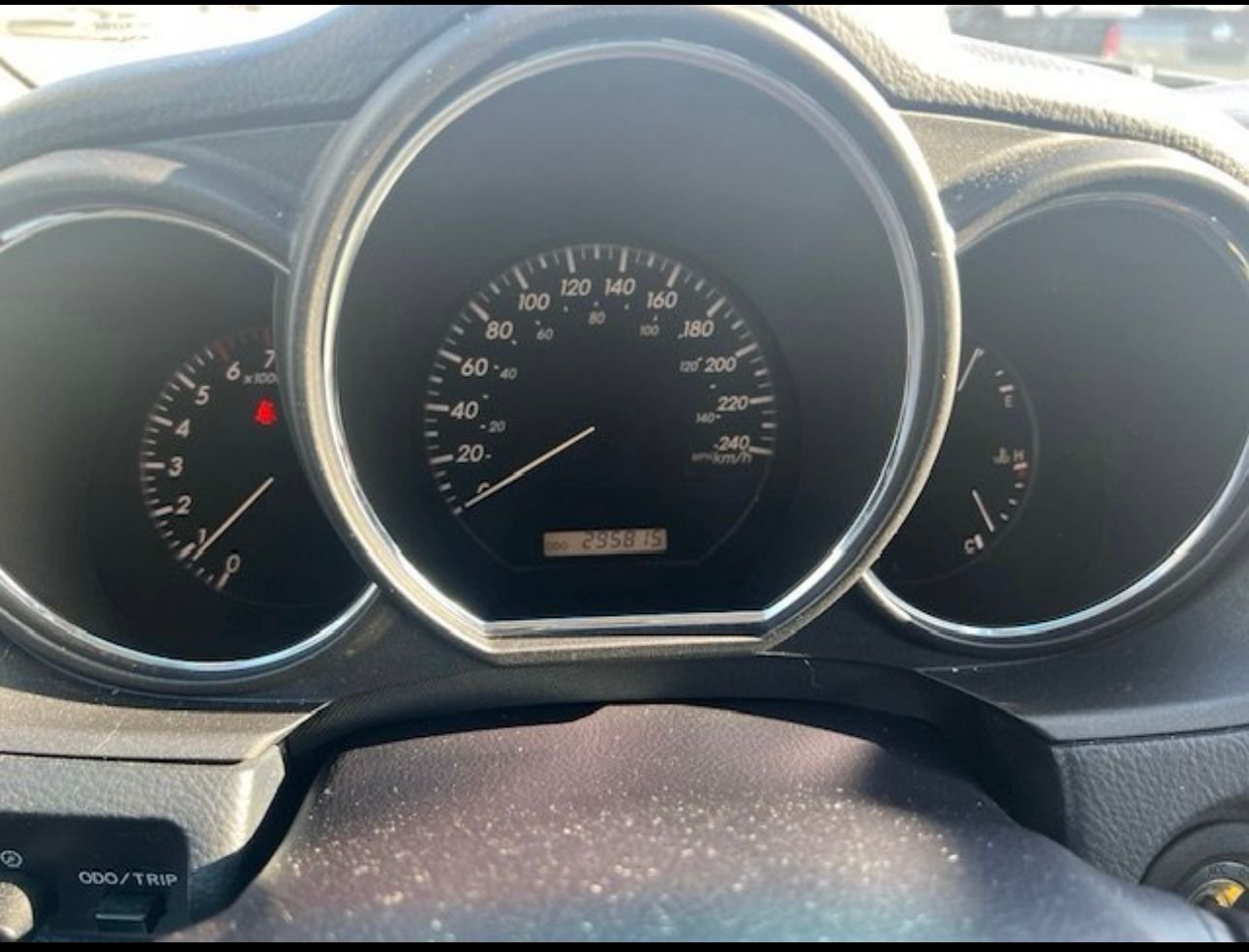

It’s a 2005 RX 330 and has 295,500kms (183,615 miles) and from the looks of it, I can’t say much about it. There are no service records available ATM but the auctioneer mentioned it is a very clean car for its mileage and “pride of ownership reflects for its age”.
They pointed out that the only flaw in this car is cracks around the dash. Exterior wise, the car looks decent enough for my intended use which is winter driving and using it more so as a grocery getter.

I'd run a car fax to see how many owners, see if the mileage jives, see if it's had accidents (Carfax is not always accurate but it is a great starting point)
What an actioneer or used car lot says aobut their product means less than nothing they have zero clue as to who owned it, how it was maintained, what it needs they will say anything that helps a sale yu=ou need qualified eys on it do not be suckered in by worthless pics run a Carfax and try to get a mechanic there to give it a PPI
Can you go inspect the car or even better have it inspected? Things to look for would be rust underneath... anything more than surface rust walk away Tyota LExus had a real problem with rust in those years
IF no rust, no leaks, no acccidents, not salvaged,not many owners no other red flags $6000 US is a fair price

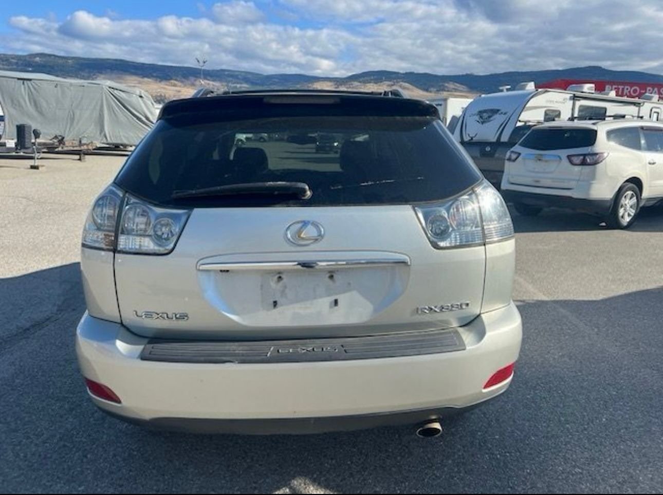

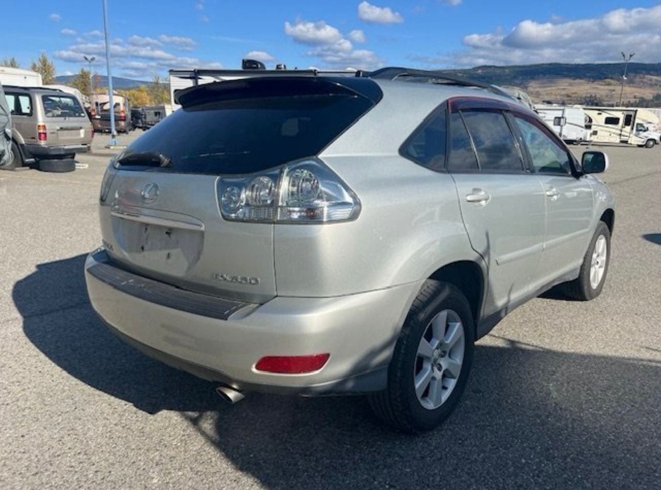

Those pics conveniently do nothing to tell you the condition and likely reliability of the car, ask for close-ups of the motor, radiator, lots from underside
Open the hood look for oil leakage, take a good look at the radiator both sides front and rear these often go at 100K miles if OEM far less if aftermarket
