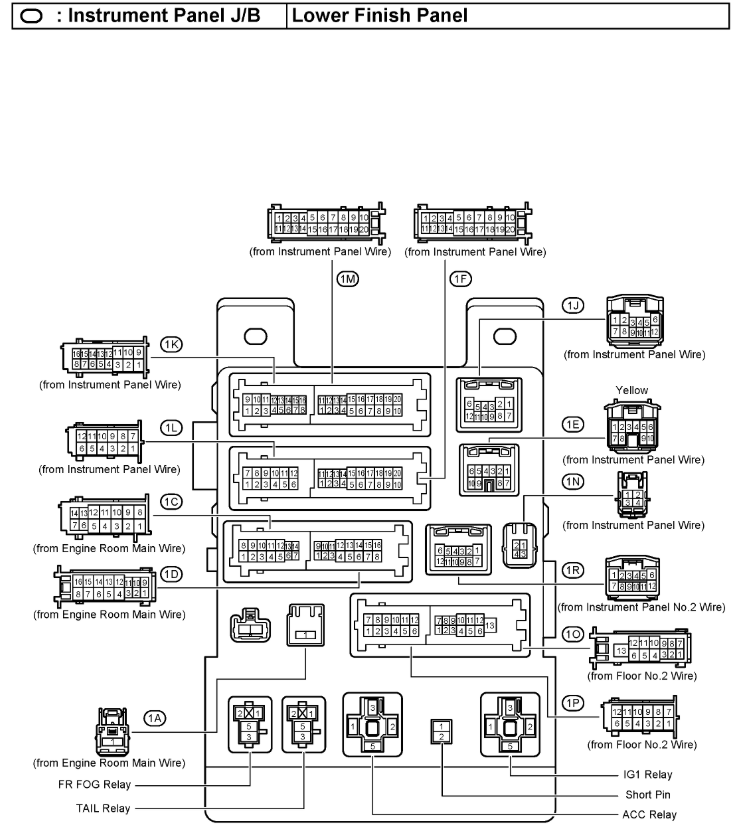

Check tail relay first and the ground next. Tail relay is the same as FR fog relay, you can try to swap each other to see if that works

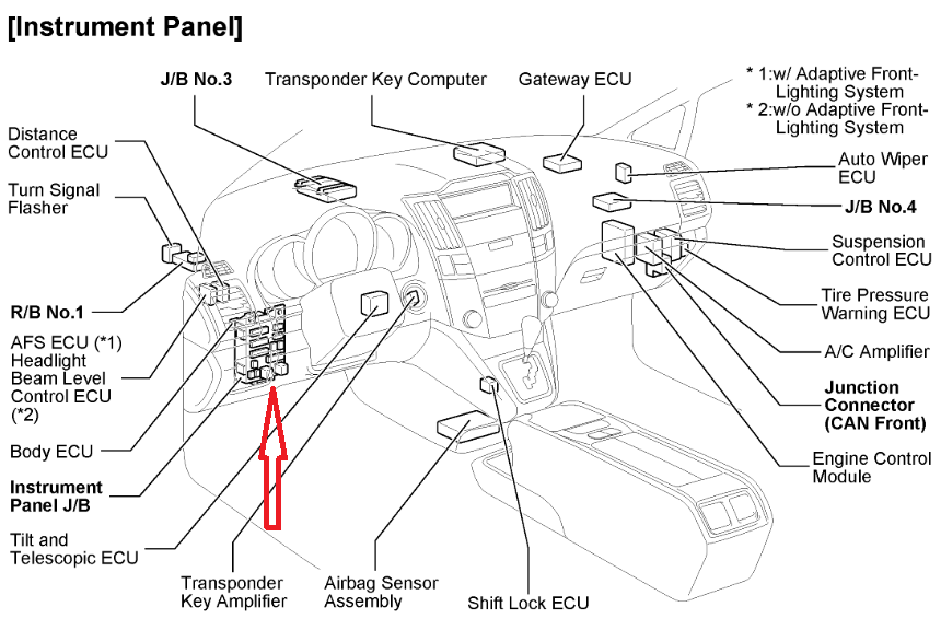

The relay box is here. Check FR Fog fuse before the FR Fog relay.
