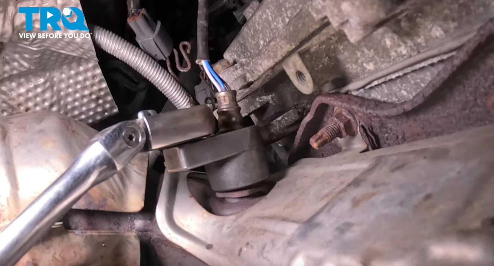

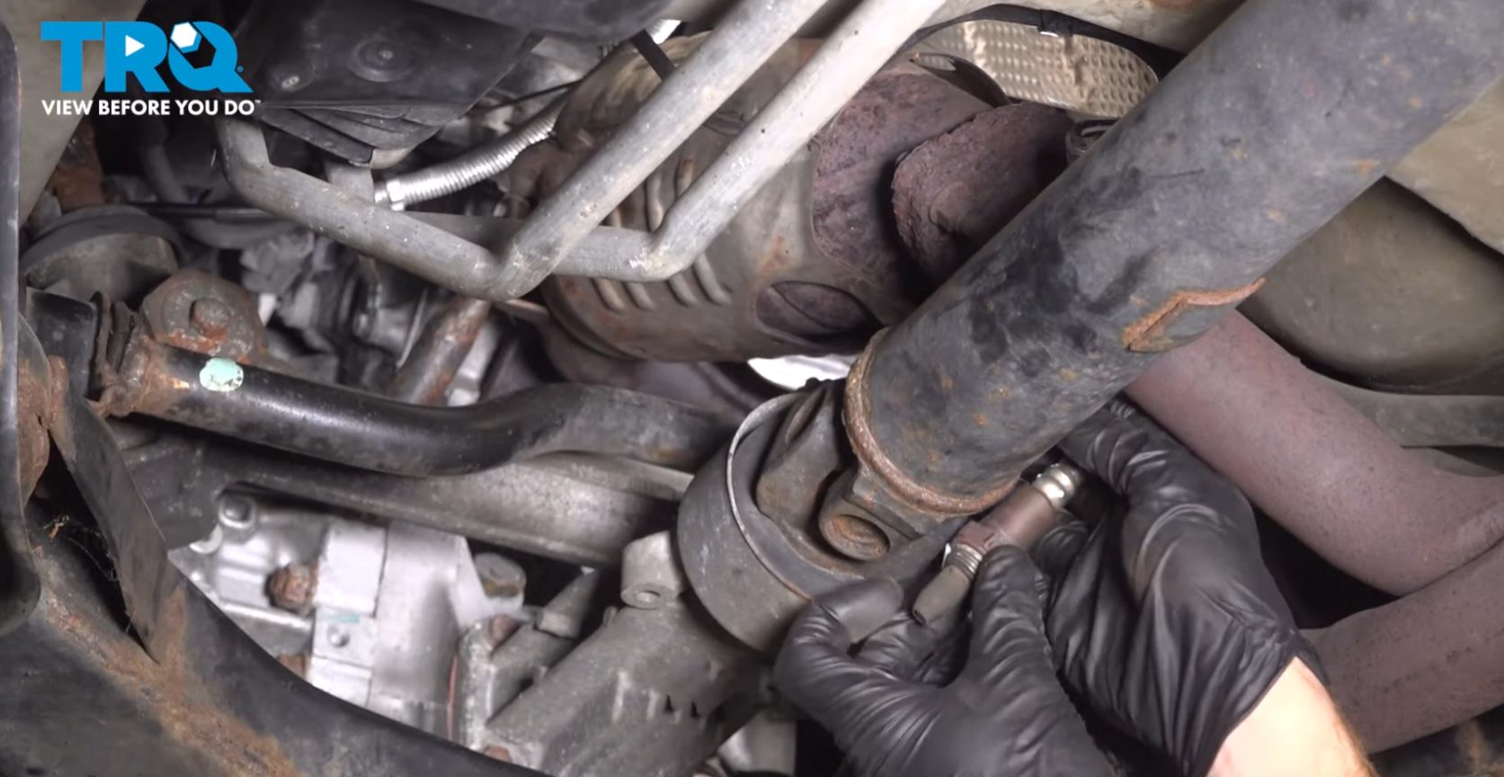

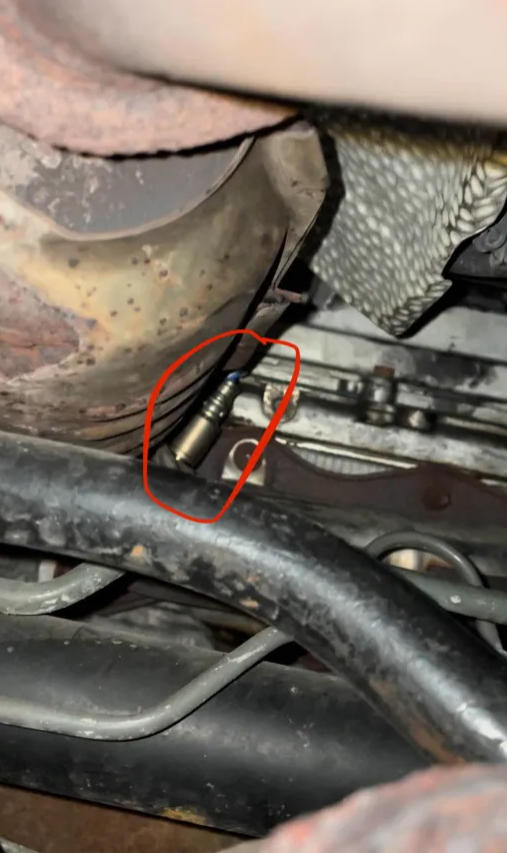

No need to jack the car up, remove the wheels or remove the intake box to get to the connector like what some people do. Just put it on ramps, use a flexhead ratchet (I used a Gearwrench 120xp 3/8" with this same compact 02 sensor tool as shown), snake it in through where the driveshaft and y-pipe are near, and popeye it 'till it breaks loose. You won't be able to get a torch in there, but these sensors don't get exposed to a lot of crud so they shouldn't be that stuck. Once you take the sensor out, snake it around the cat on the driver side so you have a sensor and wire you can yank on, then slip in a long flat screwdriver to release the tab on the connector, yank the hanging 02 and POP, it'll come out easily. I did have to pop the 4-pin connector off its plastic mount, and all work was done underneath the car in about 45 mins of taking my time
He has a similar ratchet and tool to the ones I used
Access point
