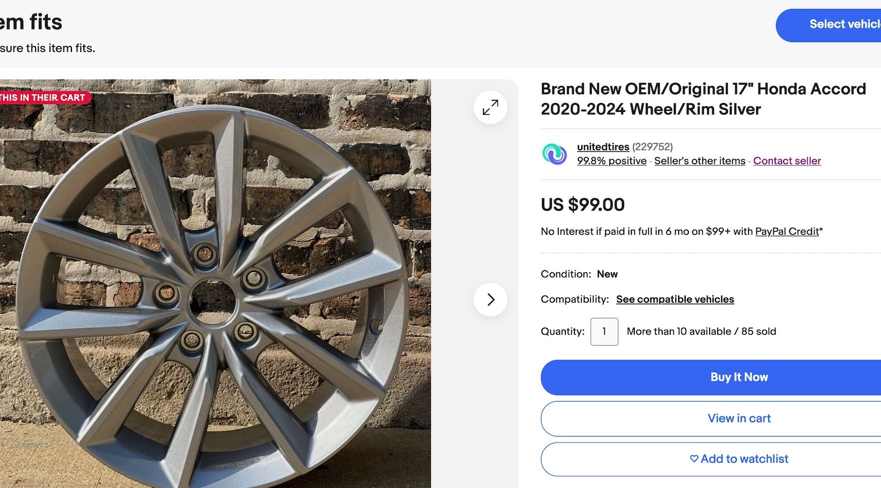

04 RX 330 is there any website or program that makes it easy to locate compatible wheels. We have 18's now but Les Schwabb is recommending 17's. He told me Rav4, is a good fit but I find it overwhelming to figure out. I looked for RX 330 but had no luck. I found one on ebay it is pretty cool. However, the results list all ebay sales.

Why change the wheels / downsize to 17s? The RAV4 ones have an offset of 45mm which is too high for our cars, stick to 30-35mm range. Honda wheels have the wrong hub bore so you'd need hub centric spacers and possibly different lug nuts too if the seat is different. Same for Nissan rims
