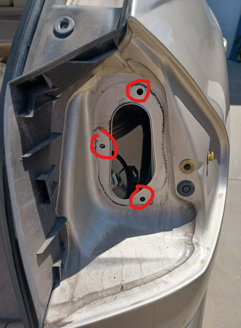

The steps are pretty straight forward, my photos are from the passenger side job, the driver side is the mirrored identical. It took me about 40 min for each side but I took my time and was taking photos, its probably a 20 min job per side for most folks.
1) Pop the panel in the trunk and disconnect all 3 wires
2) Remove the 3 flange nuts from the inside (this is the view from the outside) and the entire housing can come off

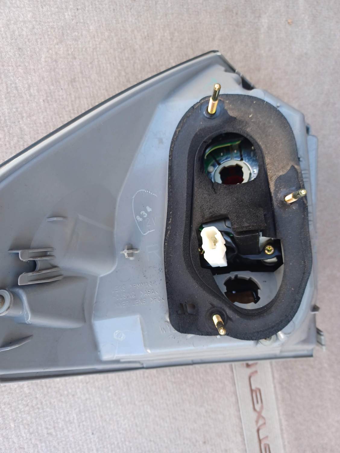

3) Carefully remove the foam gasket
4) remove the 2 hex screws and the lamp assembly will become lose and you can wiggle it out. it takes some patience and angle to wiggle out the old one and insert the new one, take your time.
5) I plugged in the wire just to show the condition of the original lamp vs the new lamp

To OP, thanks for the write-up - I just did this last month on our 2004 RX330.
1) Small hands help
2) Put a cloth in the cavity, just in case you drop one of the nuts
3) The LED disc came out pretty easy, but patience is in order when re-installing into the housing
4) Bell Lexus has good pricing on the LED disc.
Otherwise, the repair is less than an hour and pretty straight-forward.
