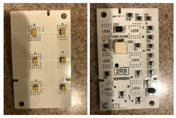

My rear LED dome light wasn't working. This is how the original looks like after I removed them. Removal is easy. Pry out the cover. Remove 2 screws. Disconnect the power and remove.
First picture is LED side and second is backside where there is a power plug.
I searched internet and asked around here but couldn't find the original Lexus part. Even if I had found it, I assume it would have been ridiculously expensive. So I searched eBay, measured original, studied plug type, and ordered this.

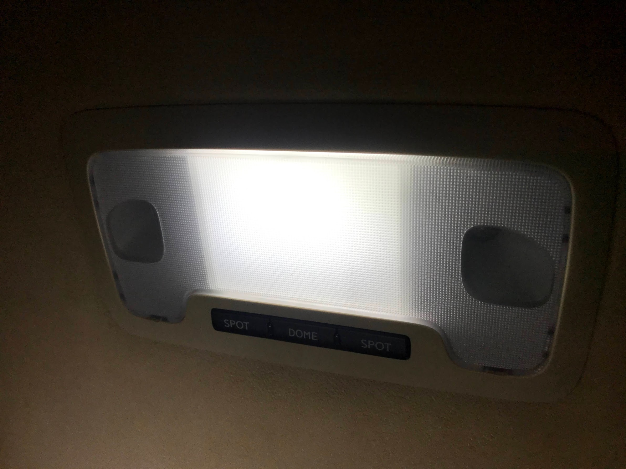

Test light with cover on. This is whiter and brighter than Lexus OEM LEDs. (Compared with front dome lights). I was afraid if it was going to be too bright but it isn't.
With both dome and spot lights on.
