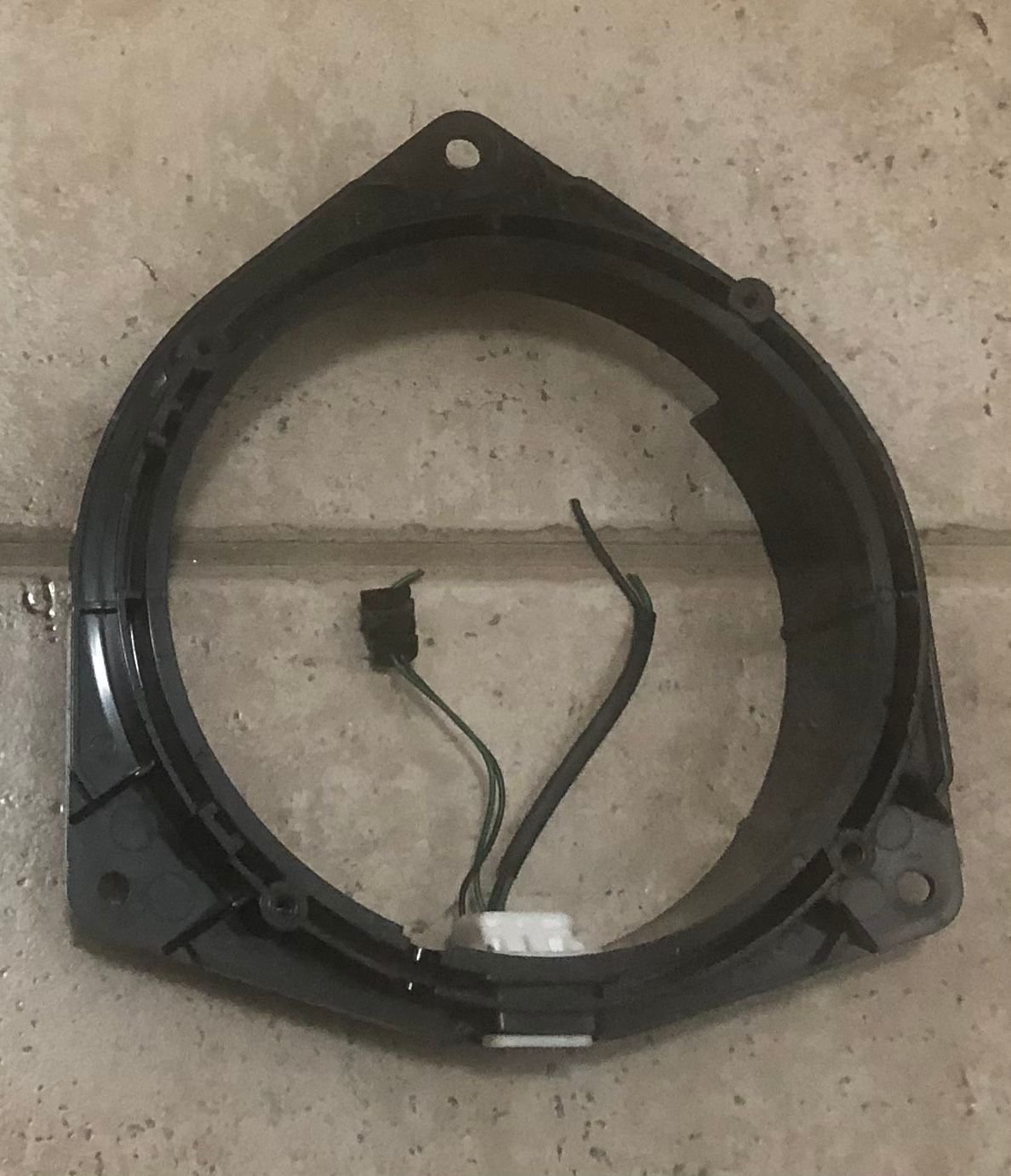

A lot of people incl myself don’t want to buy aftermarket speaker brackets because:
1. They can be expensive
2. A lot of them are flimsy
3. They don’t always have a perfect fit (mounting holes + position of speaker)
4. You usually have to drill a hole in them to run the wiring

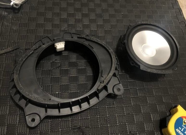

There are a few tricks to getting aftermarket speakers into the OEM speaker brackets, which ends up saving you from having to get adapter plugs as well. Certain Lexus models w/ Mark Levinson and Toyota models w/ JBL have these brackets that can be used.
Note: 2001-2007 Highlander and 99-03 RX300 speaker brackets will not fit our rear doors
Front door:
2005-2012 Toyota Avalon (JBL # 86160-AC430): Fits 6.5” speaker in front door
2004-2009 RX, 2003-2009 GX470, 2007-2010 ES (Mark Levinson # 86160-0W560): Fits 6x9 in front door
Other similar ones: 86160-0WE90 (07-11 Camry), 86160-0WJ30 (08-13 Highlander), 86160-AA382 (03-09 4Runner, 02-06 Camry, 04-10 Sienna, 04-08 Solara, 05-09 Tacoma), 86160-0C150 (07-21 Tundra, 08-22 Sequoia)
Rear door:
2004-2009 RX, 2003-2009 GX470 (Mark Levinson # 86160-0W570): Fits 6.5” in rear door
Other similar ones: 86160-0WF10 (08-13 Highlander, 2006-2012 RAV4, 09-11 Matrix), 86160-0W620 (03-09 4Runner, 04-06 Prius, 05-09 Tacoma)
