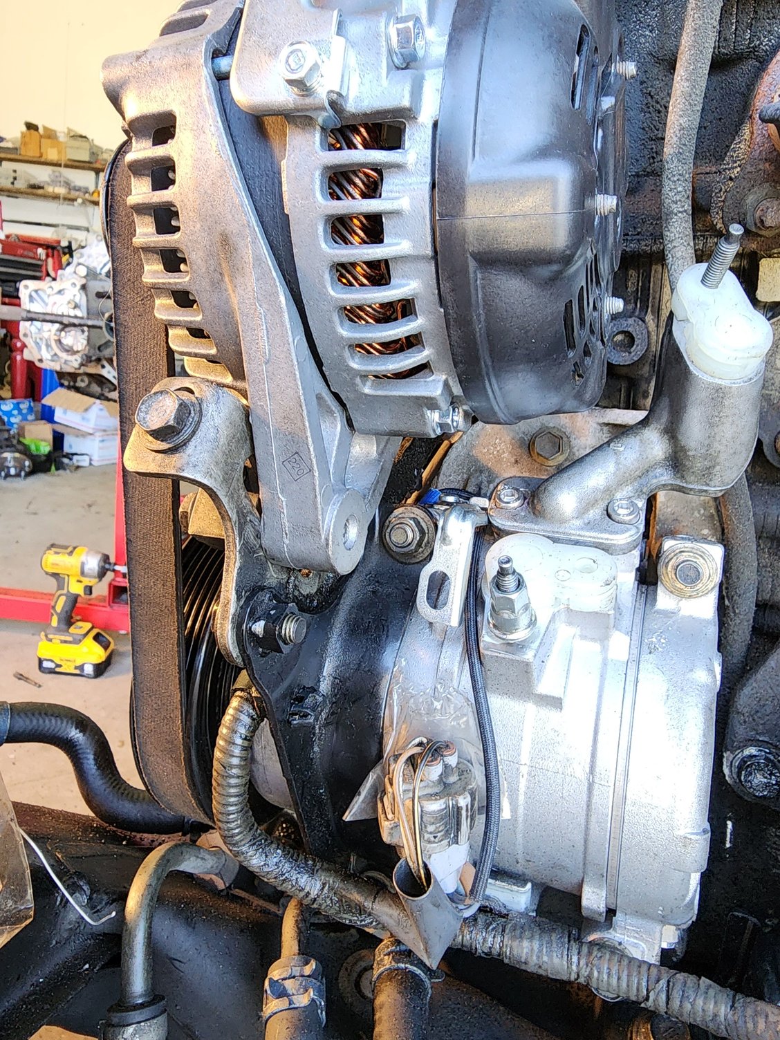

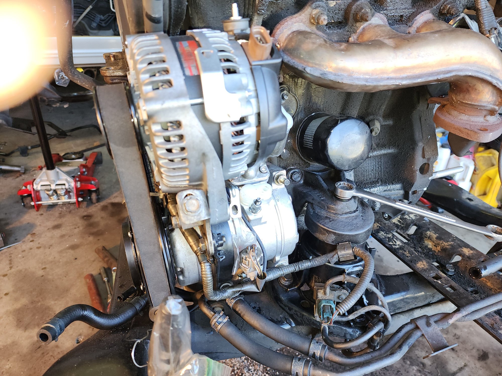

This may be a little late, but have some pics if alternator and compressor layout. I changed both out and the view with the engine out is pretty good.
Alternator has 3 bolts, and AC compressor has 4 bolts.
The alternator adjuster manages the belt tension for both alternator and AC compressor.
Enjoy

Really great photos. Wish I could lift my car off my engine too!
