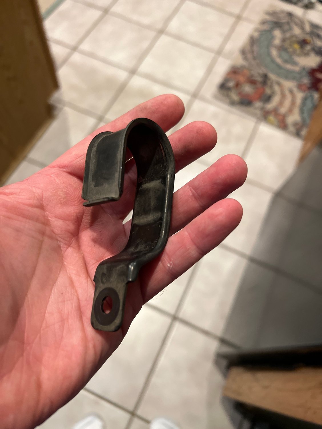

This is the part I was referring to. Connects to the back of the upper manifold. Holds a tube, thinking one of the ac lines traveling back.
Also when I mean the RX was running good before the work, I mean you could put a scanner on it and only come back with driver side air bag.
I checked the air meter, even took it out and sprayed it down with mass air cleaner.
on my scanner, I was able to do a live data sweep. O2 sensors are looking good, you can see the voltage rise on the air flow meter when you give it gas, at idle and while driving. Afr on both banks at idle are reading perfect 1.0 lambda +/- 0.1. Didn’t get a chance to see what the afr was while driving.
I was thinking possibly the coil on plug wires, or cam position sensor is slipping, with the cam sensor I would assume it would have flashed a code.
the transmission issue started after the work was done and started to drive it. It shifts hard in first like I got a shift kit on it, slips half way through second and briefly goes into 3rd and goes into forth. I can turn off o/d to go into 3rd so I’m not lugging in 4th. Before this it was shifting smoothly took me to work everyday with out a hiccup.
the only thing I did with the tranny was replace the filter, and gasket and refilled with Toyota Type-T 4
