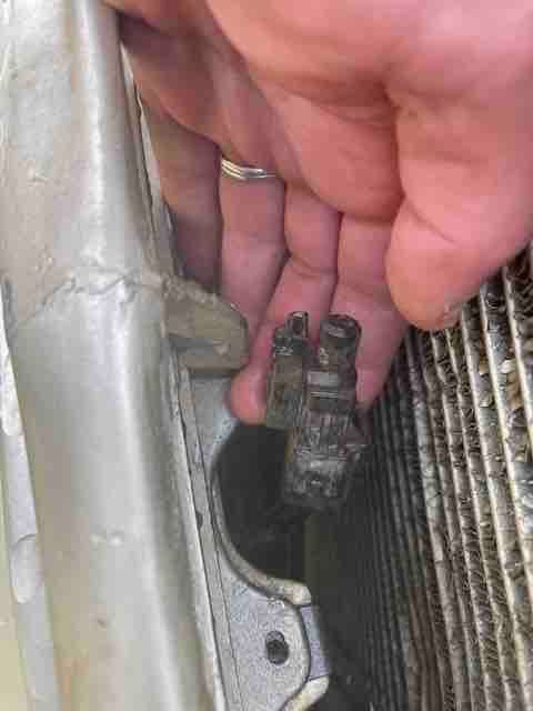

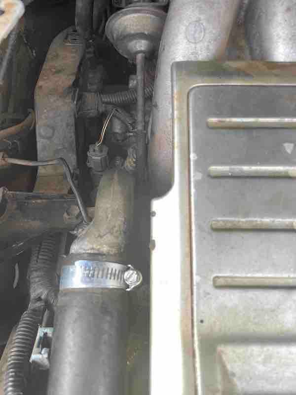

You are correct that there is a two wire temp sensor to the rear of the top hose. I cannot see a bottom radiator sensor- after a good look around I have found a sensor in front of the aircon radiator but it looks like an air temp sensor- I will try and attach photos.

Temp sensor behind top hose

That last one is probably the ambient temperature sensor

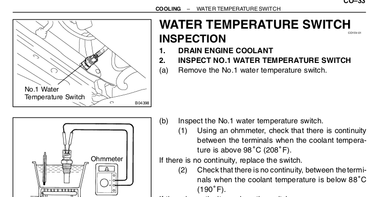

Can I add, I use a scanner to monitor the coolant temperature and make sure my fans turn on perfectly when they should.
Here is the test for the switch.
For cooling fan temps plz see next post.
