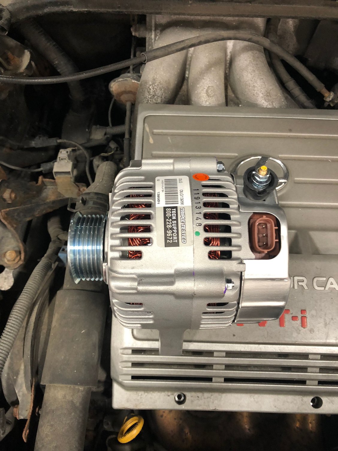

Actually failed on me on Sat.
Had a friend follw me home just in case i needed a charge.
Went 47 min (26 miles) before batt voltage went down to 10.5v.
Pulled over to jump charge it.

Actually, it was a failed alternator.
Had my orig replaced back in 2016 with a
Duralast.
That failed on me a year later. (2017)
This last one lasted 2 yrs 2 months.
So this will be my 3rd replacement.
Upgraded to Duralast Gold instead of the reman they’ve been waranteeing me with.
Hope the durability is better.
Both replacement started whining (electrical whine) 5 months before it went out.

Both replacement remans had a failed voltage regulator.
I was informed that these remans, they only replaced bearings, brushes and some contact points.
So im guessing if a core comes back to them, thes tested out whats still “working” and throw it back on a reman.
My battery tested out good each time and have no other load other than a phone charger.
Saw that access area through the front for the adjusted bolt.
Long extension with a 12mm socket.
Dont have a tension gauge but use old school tech.
Try to flip the belt until half way and shes good to go.

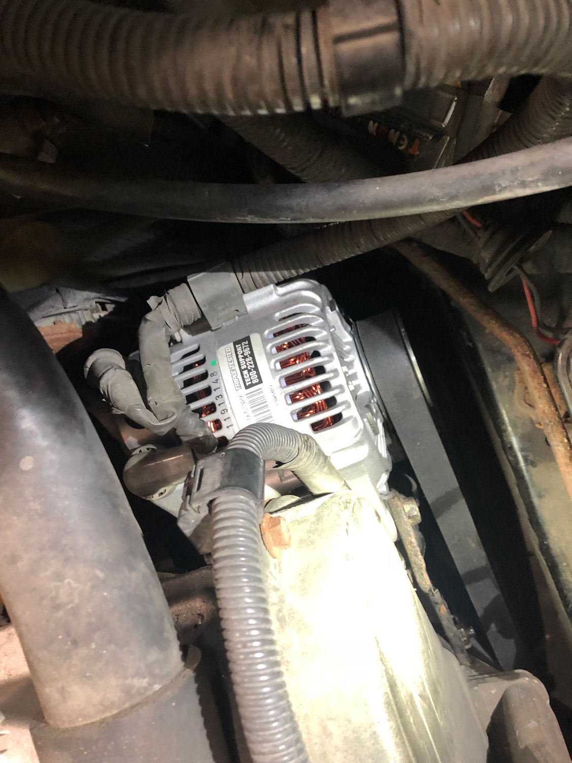

I hear you on that lock bolt for the adjuster.
The first time i did this job was around 280k.
Took me freakn over an hour gingerly working the bolt out and try not to snap it.
So putting it back together i applied anti seize grease and used new lock and adjuster bolts.
Takes me less than 15 min start to finish now. 😂
