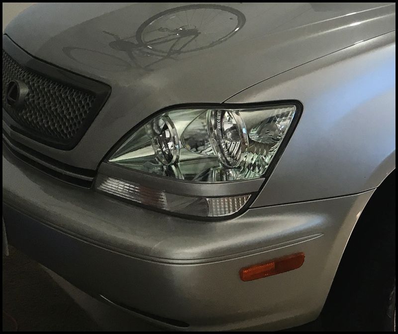

01 Original head lights

If you keep them protected with a sealant every couple of months they shouldn't yellow again...unless the vehicle is in direct sun light all the time. I use a 3M protectant after every few washes. I polished mine last year and haven't had any yellowing since:
