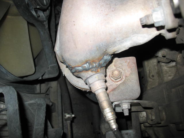

Let me show some pictures.
Below is the one that we are specifically referring to in your case, the Bank 1, Sensor 1 A/F (Air/Fuel Sensor), which is behind the engine block.

Here is Bank 1, Sensor 2, an O2 sensor (oxygen) related to the function of the catalytic converter, which is below the vehicle and behind the catalytic converter.

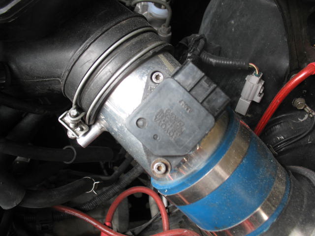

There is something called a MAF Sensor (Mass Air Flow) and this is located in your engine bay and is on the tube coming from the black air box. This picture is going to be a bit different since I have a modified intake, but the part is the same.
