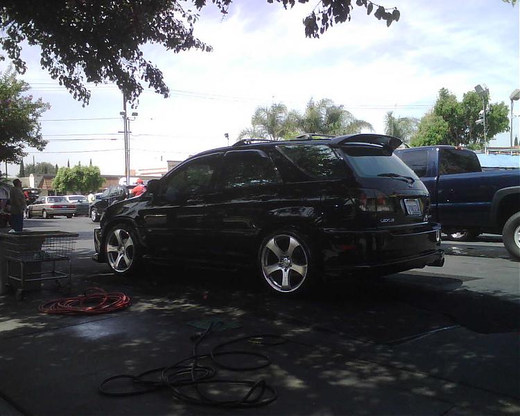

this how my look for now until end of the month .. its not a really good picture but it sitting on kyb n tein s tech
