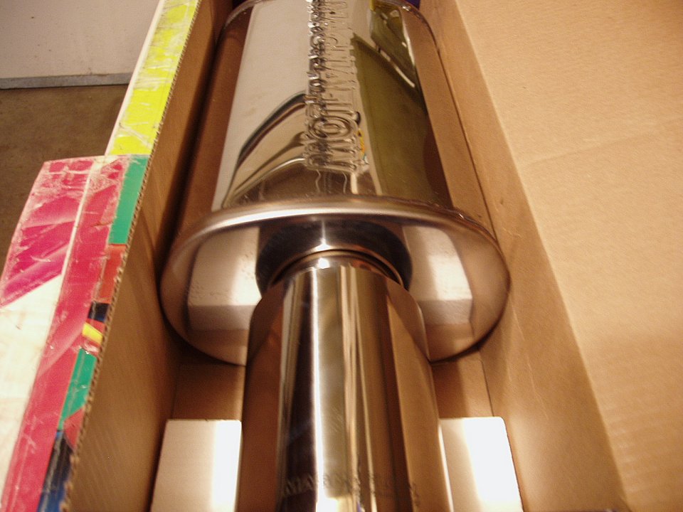

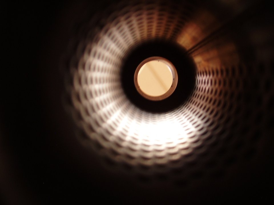

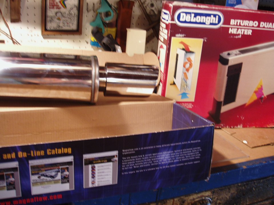

Okay I lied, I got the 14829 anyways. But I uploaded some pics for you guys of the muffler itself, sorry for the fingerprints lol I couldn't help myself.
Ignore the Biturbo heater, that's going on the RX later
I'm planning on getting this baby on in the coming weeks.
Lexmex (or anyone else ) do you know if the engine note from our RX300's would improve if we replaced that 65 foot resonator or is it already straight through? I know a straight pipe would make it obnoxiously loud and nasty. Also how's your new kitty?
-tc

Would I would do first is see how you like it with just the Magnaflow itself.
As I recall that resonator was a straight thru (and due to its size) that is why it kept everything quiet.
I got rid of it because weighed a ton.

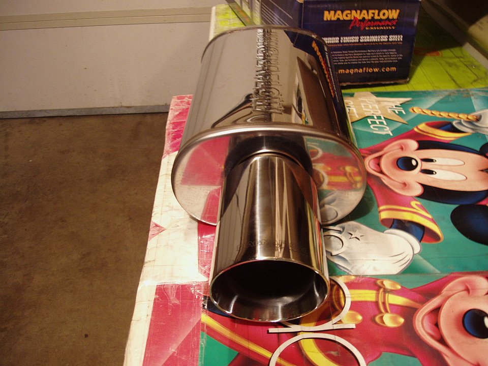

Sorry for the crap@zz pics earlier, and these aren't much better but they show off the muffler a bit more. I'll definitely have sound/vid/pics when I'm done with the install.
