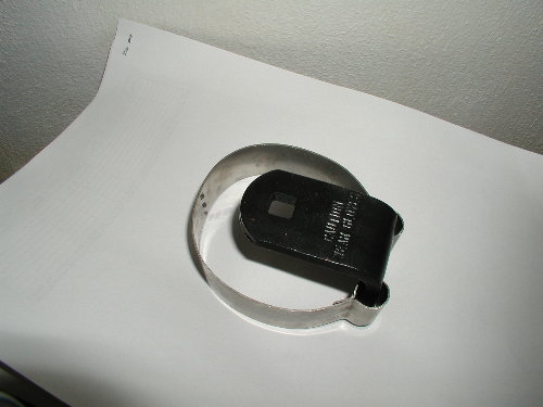

Talking Oil Filter Wrench
You won't be able to get to the filter from the top if you're built like ARNOLD, even if you removed the horn and radiator... : )~ You have to have girly arms, which unfortunately, I have...
If you go from the top, you won't be able to use those cap type filter 'wrench' because those always tend to slip when the filer cap and filter don't fit just right. You can bypass this by using sandpaper for grip, but it's just a hassle.
I use a loop filter wrench (attached) which just goes over the filter, attaches to a 3/8" socket (with 3" extension) and turns the filter in the direction of the wrench. To tighten, turn closkwise, to loosen, counter-clockwise. Very easy, no grip problems.
You can get this at any of those generic car part places for around $10.
The filter location is a b-tch to get to, but with this filter wrench, makes it better.
