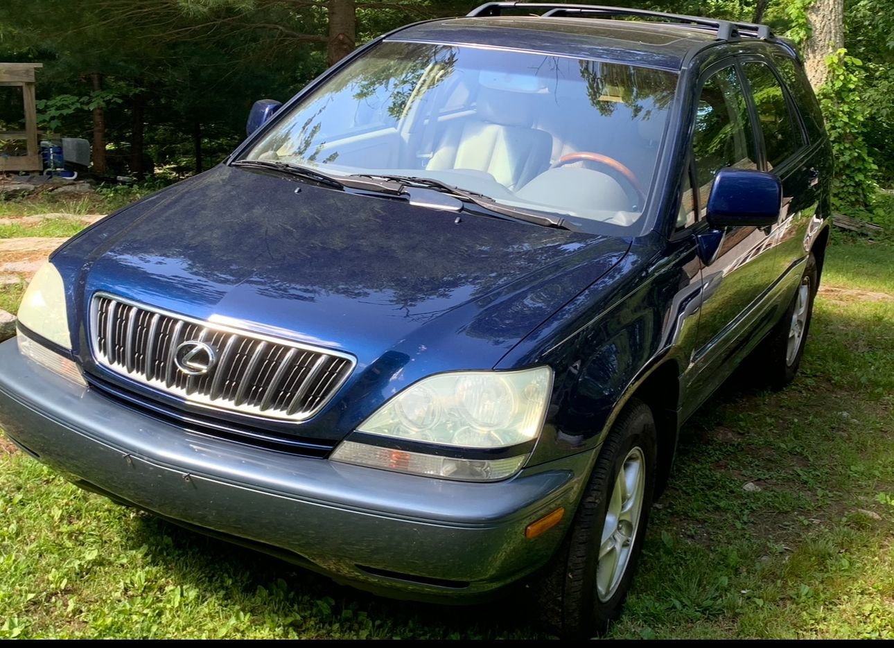

Hi,
i have rx300 with 247k miles. Shes a little gruff but love it. Anyway just told my mechanic while picking up my 330 from service what was going on and concerned of knock sensors and he shook his head and said it's probably something else.
