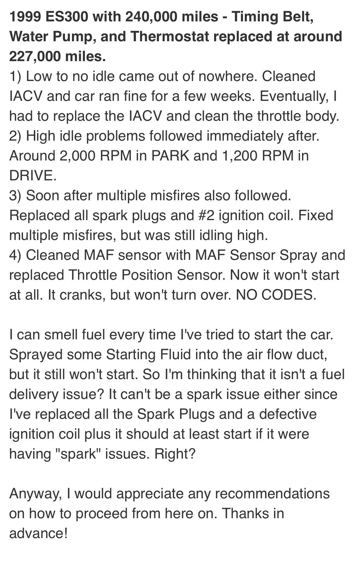

Good evening,
So I found this post and it’s pretty on point with my situation. What’s your thoughts?

Lets not discuss ES here in RX forum.
You are confident that you are getting fuel. [Confirm with little burst of starting fluid].
You are assuming that you have spark. Don't assume take the most convenient plug out and lay it on the block and confirm there is spark. Imobilizer may be killing your spark. Once you take the plug out, you can confirm fuel if the plug is wet.
Air .. we talked about keeping the throttle 1/4 down so idle circuit is bypassed.
Timing.
Missing ground or pinched wire during last service. Go over your work.
Salim
