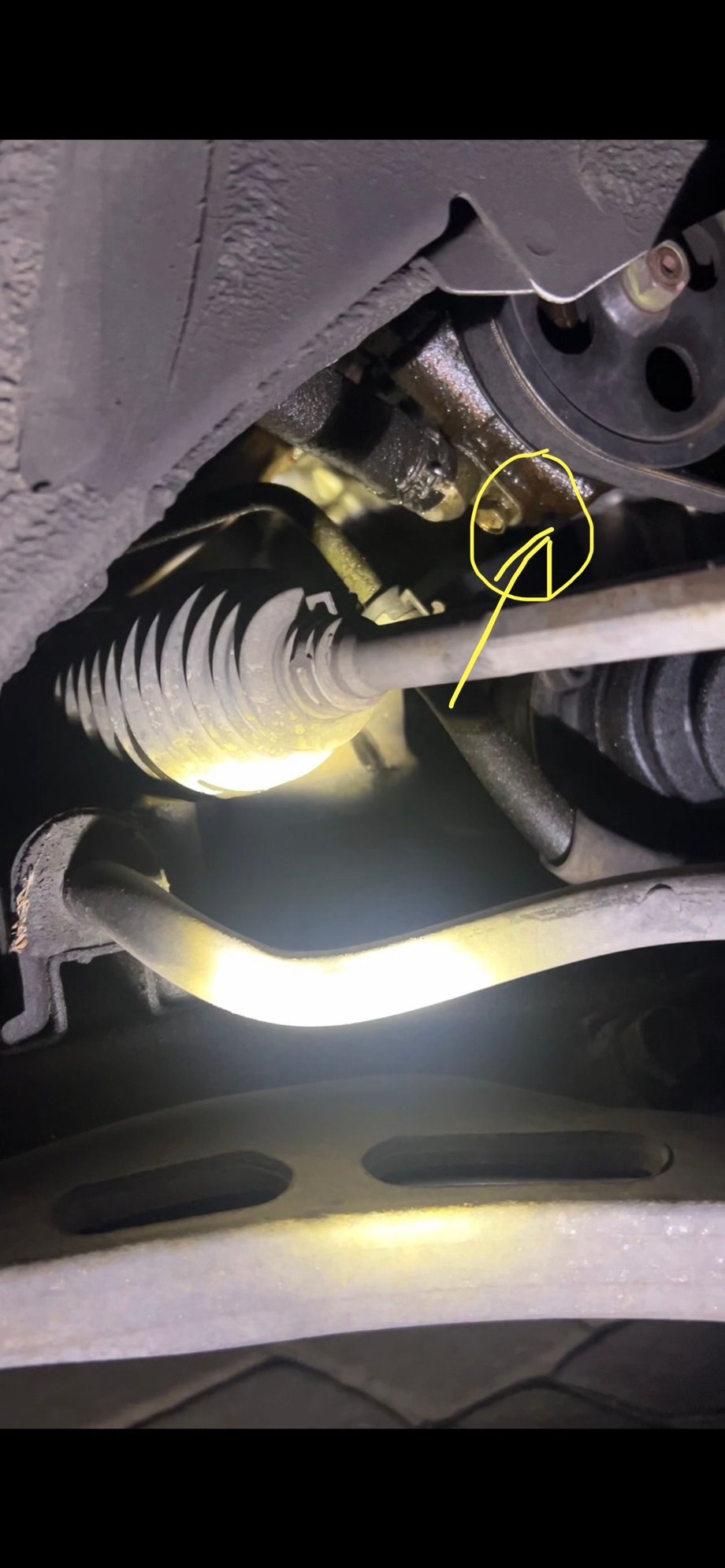

Can someone help confirm / advise if this leak is coming from the pump? I looked around it doesn’t seem to be coming from any hose connection points.
ps is at 170k miles. It’s a really minor leak but still causing spots all over driveway. I’m suspicious switching to synthetic caused the issue.

Can you observe a fall in the level of the reservoir. If the leak is slow, it will take longer to make a noticeable difference.
Inspect hose and connections and bearing seal.
Salim
