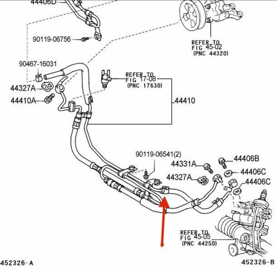

The high pressure hose is the other one in the picture with the crimped on fittings. Replacement isn't too difficult. Another possibly cheaper option is having a hydraulic hose shop make you a new one once you get the old one out.

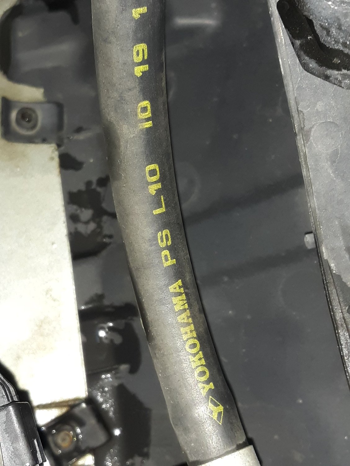

Default Yokohama
Correction; Yokohama is brand hose.
Attempted using 3/8" I.D.(9.525 mm) hydraulic hose on a 1998 LS400.
It was brutal attempting to stretch the hose over the raised crimp areas of metal lines...so you have perhaps an extra mm to overcome...so then force it to push it over an inch of hard line.. and hydraulic hose, which is designed to resist expansion does not stretch well...and you end up damaging or fracturing the metal.line...
Then the OEM clamps may not be compatible with the OD of the selected line.(on mine they are used at 3 or 4 junctions....so 6 or 8 constant tension clamps)
It is entirely unsafe to use worm style clamps on high pressure hydraulic hose....which is likely to happen if an uninformed do-it-yourself decides to save a few pennies.
Image of P.S. hydraulic hose and P.N. used on 1999 LS400.
