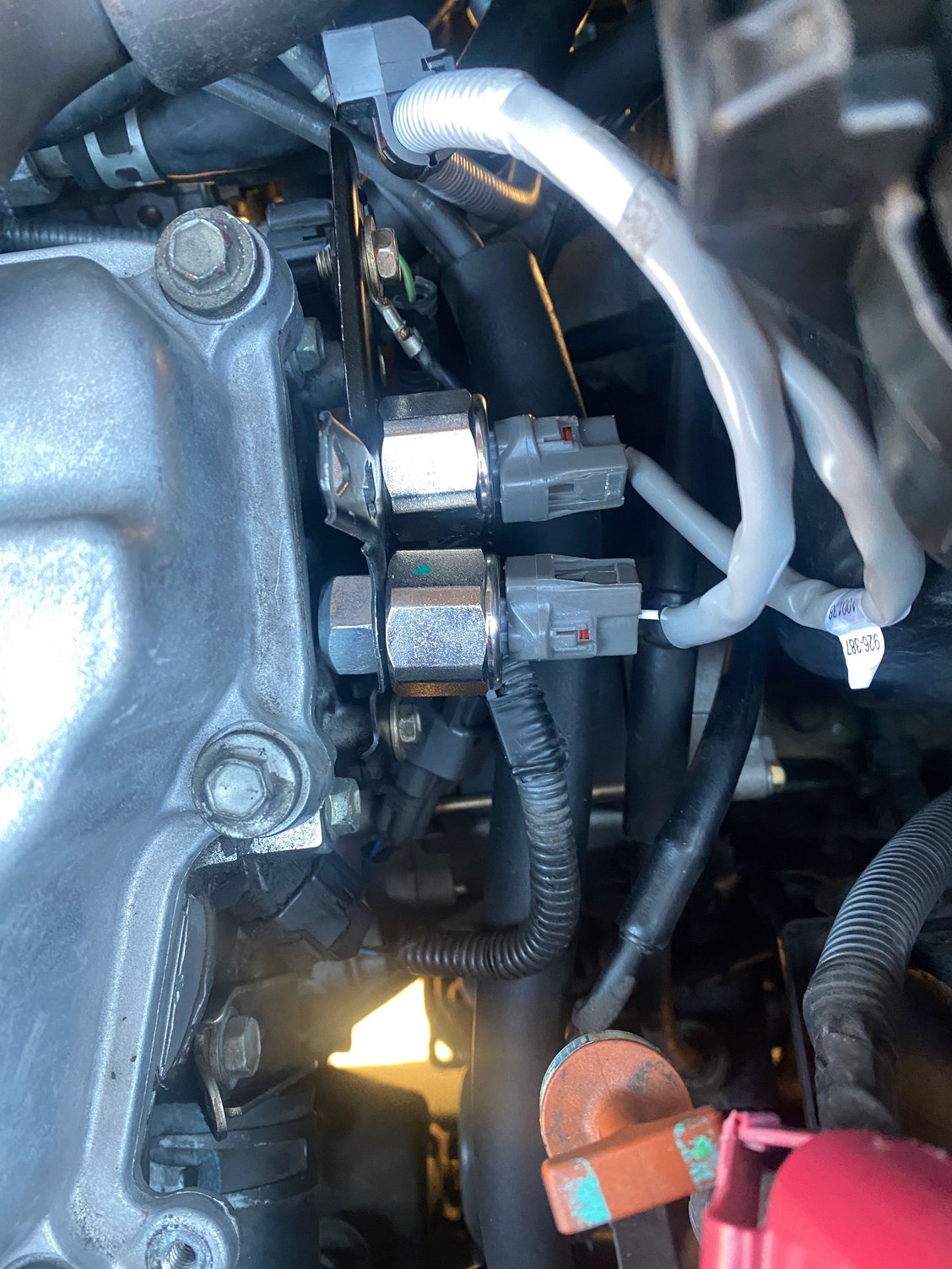

Thanks for the replies. We are losing a very small amount of coolant with no external signs as of yet. My concern is prior owner replaced the knock sensors due to a real condition causing a code such as coolant in combustion chamber. For now I went with Beck Arnley, (I know its better to go with Denso - this is temporary until we fully diagnose the coolant loss). I installed the 2 knock sensors on the plate on the drivers side of valve cover. One interesting thing. Depending on which wire I attach to which sensor it will throw a 330 code but then when I switch the wires no codes at all. Does the ECU sync with one sensor then later if switched it detects that then throws an error? I noticed one sensor has a green dot. I also pulled the radiator side plugs to inspect to see any signs of coolant in combustion chamber., (picture attached), and debating weather to properly install Denso or Beck Arnley sensors. Its a very tiny amount of coolant loss.

The sensors have two separate signals to the ECU. The diagnostic even says swap the connections to see if the problem moves.
If the problem moves it's the sensor. If it doesn't it's the wiring. No mention of "if it goes away".
Any chance these wire are spliced at the ECU? That might explain it.
https://www.clublexus.com/forums/rx-...ck-repair.html
Check the front of the engine by the oil filter. I've had a very slow coolant leak there for years https://www.clublexus.com/forums/rx-...l#post10932797

Yes the error goes away - depending on which wire is to which sensor there are not codes! With the 330 it was also disabling the overdrive. It was perviously spliced with the old , (cheap harness from Amazon previous owner had installed" to one of the new Beck Arnley sensors, (sorry I left that out - devil in the details). The latest code was with the new Beck Arnley Sensors/harness attached to right valve cover side plate hack which went away after switching the wires.
I will check the ECU. But if it were hacked I would think the error would reappear. No codes at all at this point with carful minimal driving. Previously the code would apprear after a mile or 2...
