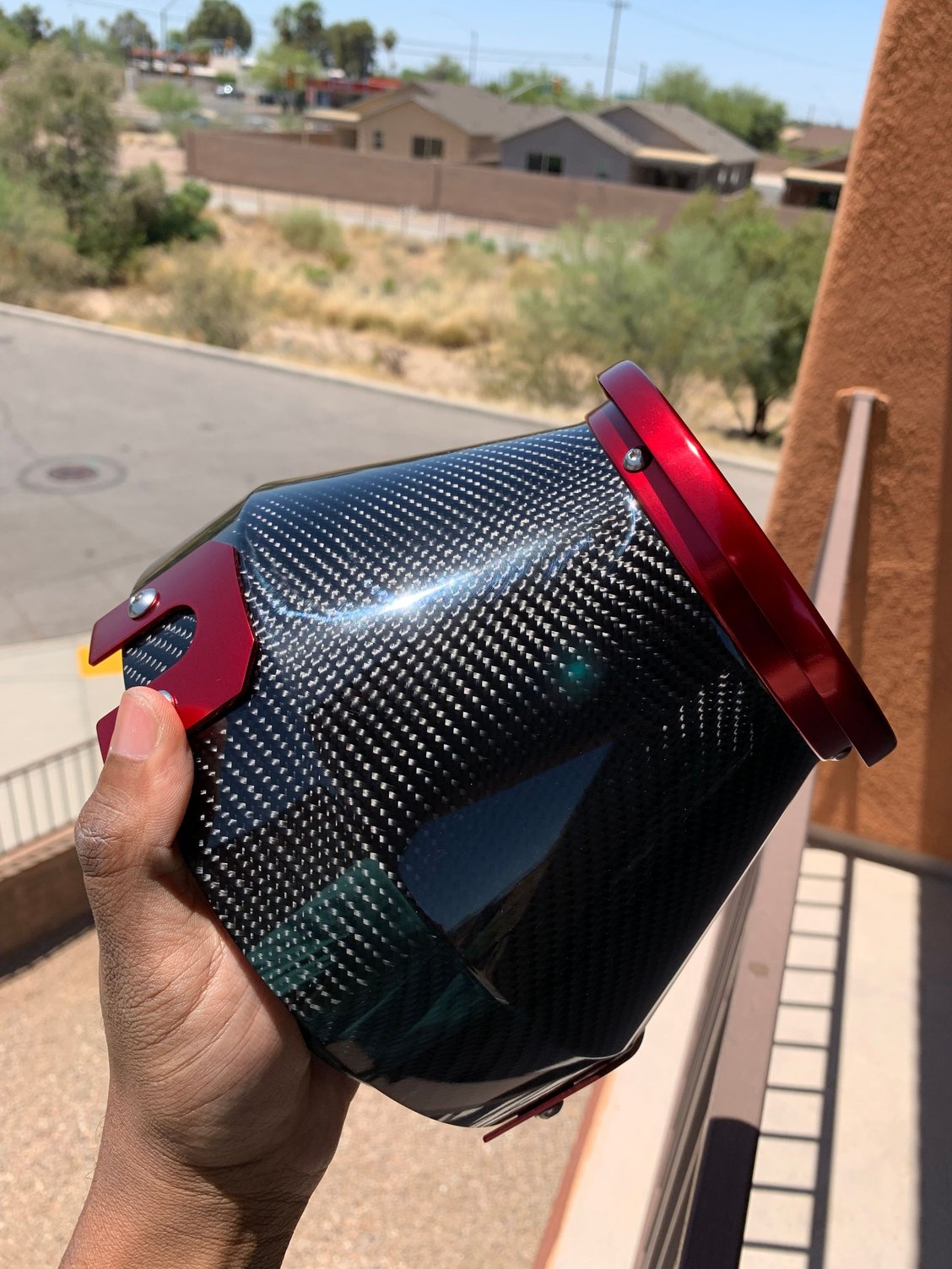

Custom intake (cone filter from takeda intake, heat shielding from the aem intake, performance mrp billet aluminum maf housing with air straighteners, and MIJ titanium elbow

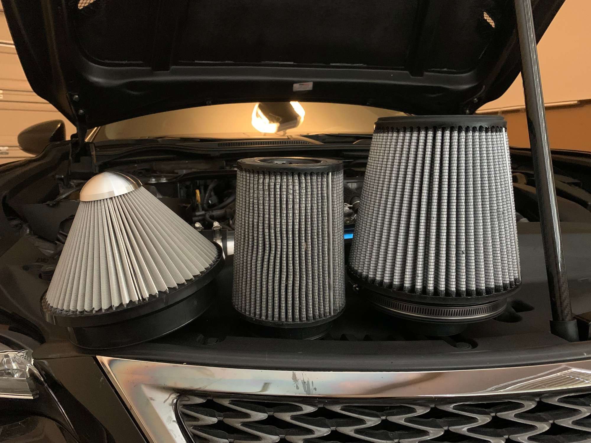

He definitely recommends having some kind of heat shielding. Building a custom setup was cool. I went through 3 other setups including a 6 to 3.5 inch velocity stack and different size filters. After logging maf readings, they all sucked in a lot less air. Afe power with the inverted cone performed 48 to 51.8.lb/min the others all did around 35 lbs/min. Cool learning experience that bigger isnt always better .

Thanks. Did you test the dry AFE filter or the wet one? I have the wet one as part of my AFE Power Takeda CAI. Supposedly, it gives a bit higher flow rate than the dry one.
the one i tested was the dry filter version. I heard about the oiled filters flowing more too. Would be cool to know how much more.
do you have a part number for this filter?

part number is tf-9027d

is the top inverted on the afe with the 6" base/velocity stack?

The bigger filter didnt have the inverted top. Maybe they have one that does but im not sure. Luckily the afe filter that came with the takeda fits 3.5 outer diameter pipes so the maf fits in there perfectly.

That looks pretty sweet! Can we see a shot of the engine bay?
