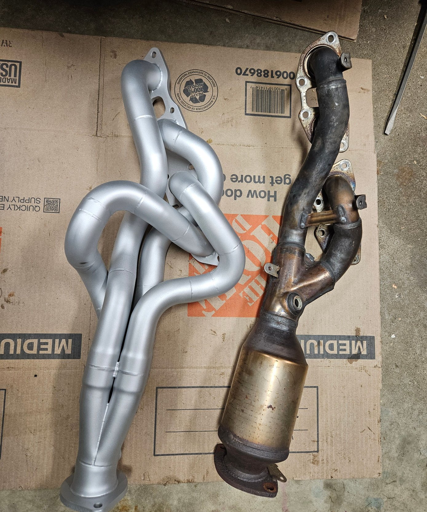

Well I'm just finishing up installing a set of PPE Equal Length Headers onto my Apexi cat back exhaust system for my 2018 RCF. I choose NOT to add "cats" to any part of the exhaust as I'm not in a state that requires "inspection". I installed the Apexi cat back exhaust earlier this past summer and I love the sound and look. But I wanted the additional power and sound of actual headers. I almost went with Novel as originally I was told only around 8 weeks for delivery, however, I heard later on that "they have no idea when they'd be delivered and Novel has over 3,000 back orders. Once I saw that, via an email, I decided to move to PPE Equal Length Headers with "silver" ceramic coating and no CATS. I installed the Apexi cat back in my garage myself and while I had planned to pay to have my buddies shop install the header's, he wanted no part of the job so I decided to do it myself. My 2018 only has 15K miles on it and it's really never seen rain, and certainly not a winter, ala "salted roads", so the car has ZERO rust anywhere underneath, making this job actually not bad at all. I'm pretty mechanical and have upwards of 75K in Snap On tools in my garage. The PPE headers are VERY Nice looking and they fit and clear everything perfectly. My only major complaint were the terrible installation instructions. For being made here in the US, I expected the instructions to be very clear, concise, and leaving few questions for the installation. That was NOT the case at all. I wasted a lot of hours trying to figure out the instructions, what exactly was required to be removed to do the installation, and I found several additional things that had to be removed to install the header's. I wasted a lot of time going by the instructions trying to remove various engine parts when in the end, additional items had to be removed in order to get some engine part removed or to install the header's. The actual "order of removal" left some to be desired too. Now that I've done this job, if I had to do it again, I could do it much, much, faster and with alot less aggravation. It states "professional installation recommended / install time = 8 hours". If I had to do it again, here in my garage with the vehicle body only 20 inches off the ground, I could do it inside that 8 hoursi believe. It really wasn't that difficult at all, made all the easier by my car having zero rust. If anyone has any questions on installing these PPE Equal Length Headers, feel free to hit me up. Looking back, I wish I had taken some photos and videos of the installation, but if anyone needs help or has any questions, I'll definitely respond to you and try to offer any help I can provide.
I'll post back once I get the opportunity to drive the car. I'm in cold, snowy, Minnesota so the car is going to be moved to climate controlled storage some time this week. I'll take some video and get some sound of the car with the PPE Equal Length Headers now installed with the full Apexi Exhaust.
Passenger Side Stock Exhaust Manifold and PPE EL Header
Equal Length Tig Welded Tubes #1
Equal Length Tig Welded Tubes #2
PPE Flange Thickness
Equal Length Tig Welded Collector to Mid-Pipe Flange (lower)
Upper O2 Sensor Hole
PPE Head Flange (upper)
