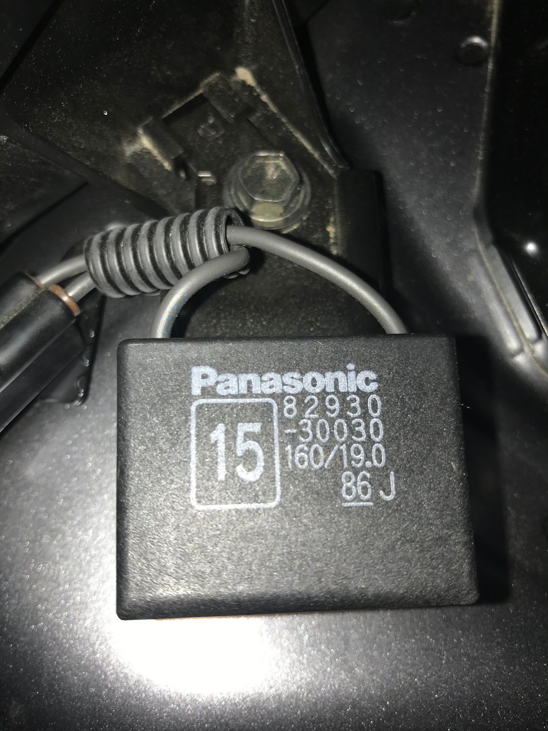

Default What is this and what does it do?

Originally Posted by Dribble
I believe its some kind of capacitance module sensor for you airbag. In the event that your car loses electrical connection with your battery during an accident this module will trigger and provide the auxiliary power to deploy your airbags.
I may not be precisely correct about how it works within the circuitry but close enough.

It's interesting Lexus seems to source its electrical energy storage devices from Panasonic. OEM car battery is Panasonic and then to see this too.
