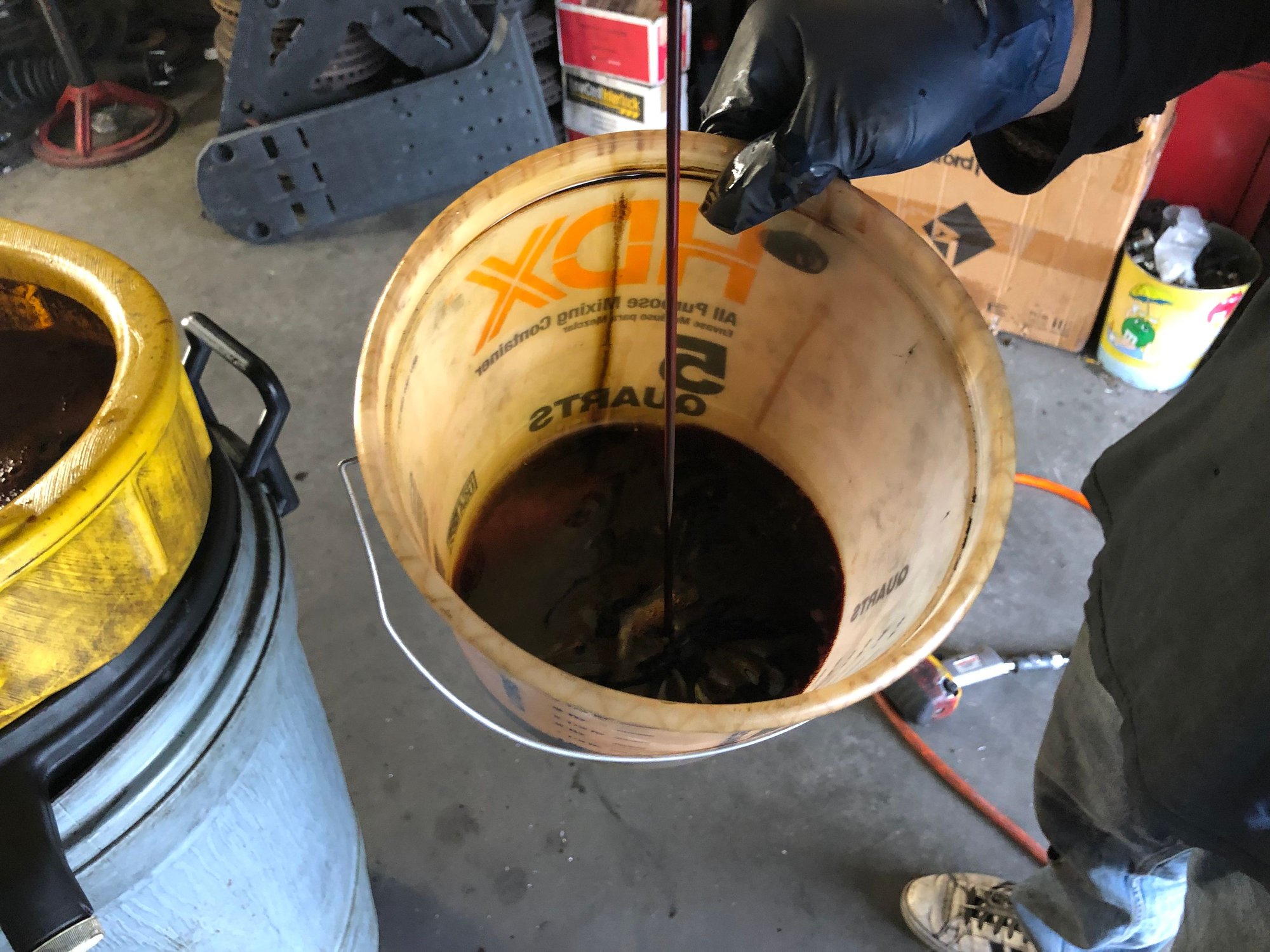

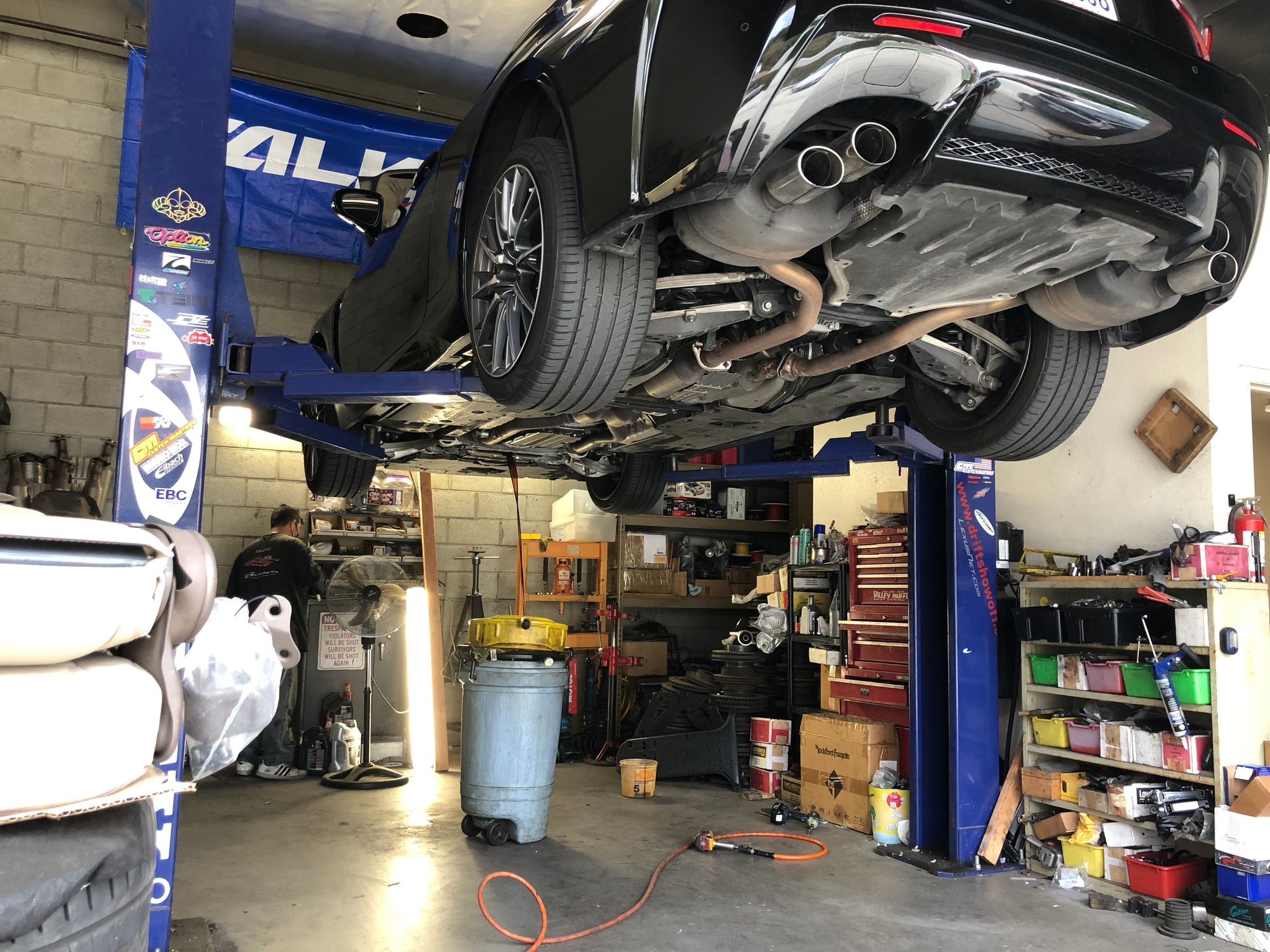

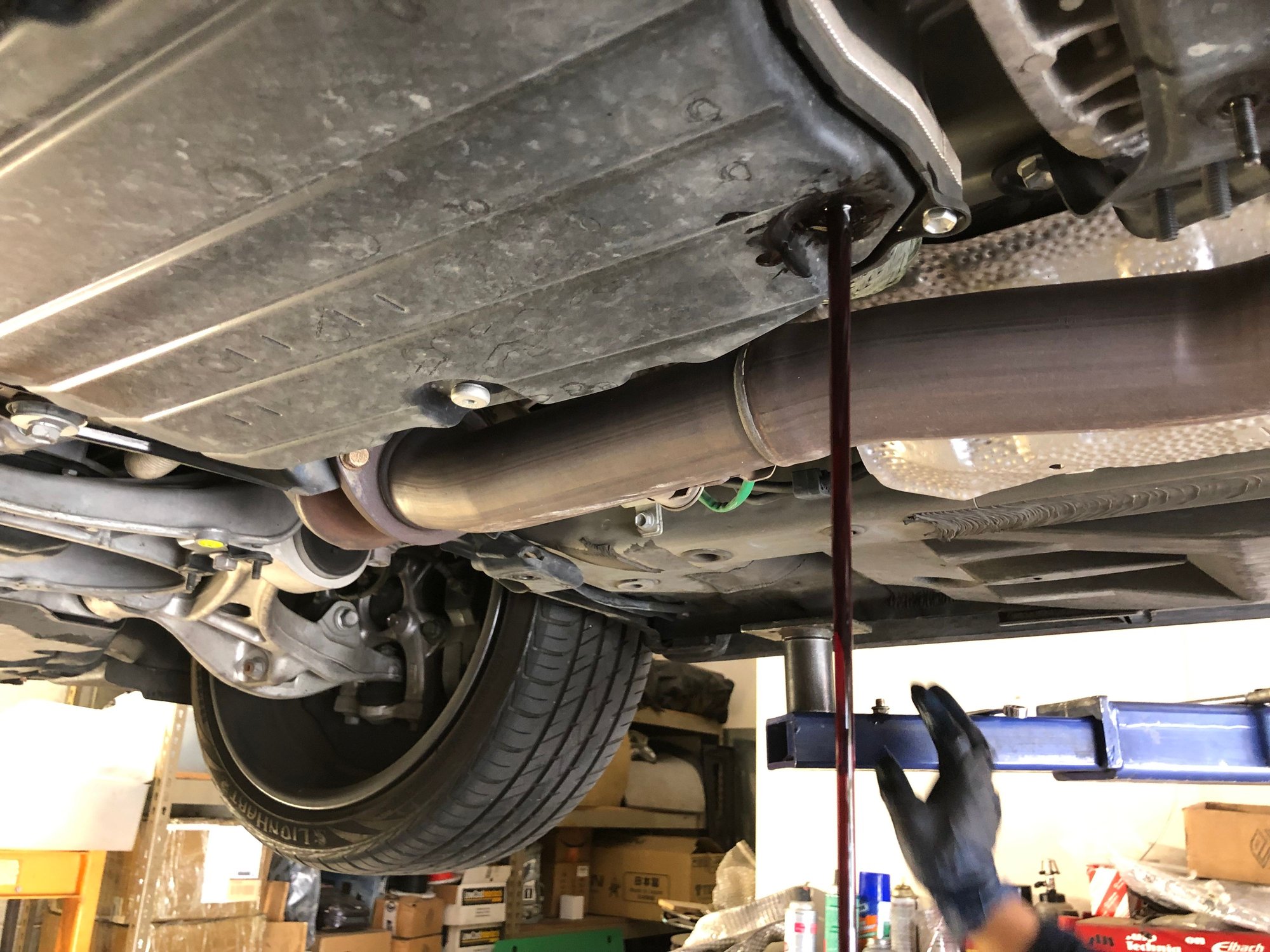

Just got my transmission fluid changed out at 63k miles at Tommy’s of Music Box in El Monte. Tommy was a Toyota mechanic that now works on his own and is available to do maintenance, suspension, and exhaust work on Lexus vehicles for people in the LA/SoCal area. There’s a whole thread about him in the So Cal forum.
I brought over 4 bottles of WS ATF for him to drain and fill and had the opportunity to watch as he he did the service. I did find that the fluid drained out was almost black and even though this fluid is considered “lifetime” I wanted to change it out. Tommy found that I was a full quart low (which would explain why my shifts were a bit harsh). I can say that the car drives so much better. Shifts a bit smoother too. I’m sure that is attributed to my fluid level being low rather than the condition on the old fluid as some guys here have tested their fluid at 60k plus with no issues.
Im pretty happy with it so far. I got the fluids from Amazon and Tommy did it for $100 flat.

That fluid crossed over into another realm, no longer ATF. I've said it many times, think about what "lifetime fluid" really means. Lifetime, what is that? It is the total life of something, could be 1 trillion years, 1 nanosecond, 1000 years. It is not false advertising to say lifetime fluid, but the suggestion is it will last as long as you need it to. Not so, the lifetime will be reduced.

I would have loved to have sent it to Blackstone to be analyzed but just knowing I was that low at only 60k was alarming. Car shifts great now. So glad I did it.

Remember, this is an 8 speed transmission we're talking about. If you drive your car spiritedly or on the track, your transmission fluid will grow pretty disgusting pretty quick. At 60k miles though, that is slightly alarming to be down about a quart.

Wow. I wonder what the max life is on this fluid and why it lasts so long. After seeing the fluid I was shocked at how dark it was but that’s not always a tell tale sign of fluid going bad. Now I wished I could have sent it to Blackstone.

The transmission oil was dark again. This was my 2nd drain and fill with Tommy so I have two more to go. I know color is not an indicator of oil life but this is more for peace of mind.
