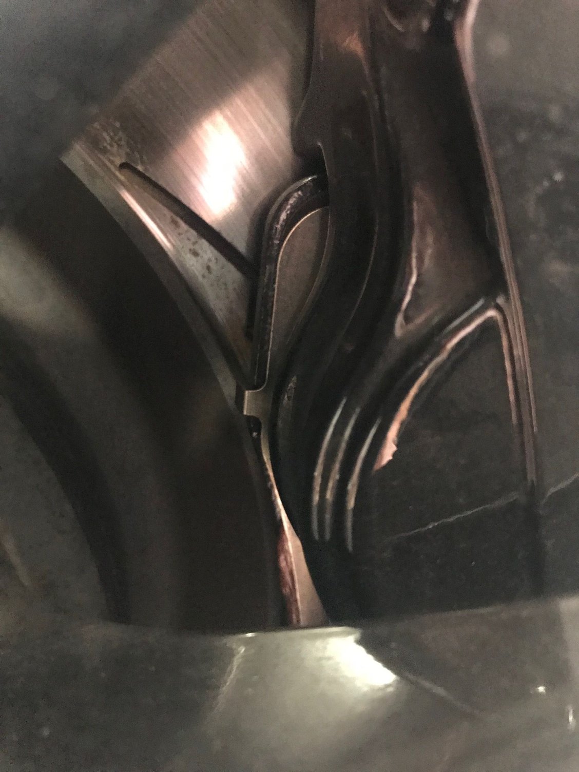

Here's what the rotors look like. It looks to me like they are not gripping the last quarter to half inch of the rotors. And I don't remember being able to see the pad sticking out past the caliper. Am I being paranoid, or did they install the pads incorrectly?

What brake pad is that? Aftermarket brand? I don't remember seeing the stock brake pads come with that shiny backing plate. And it doesn't look like it's seated correctly, maybe the wrong pad was being installed in the first place? The grooves do look like they're deeper on the outside vs. inside of the rotor, I think your suspicion is right, that it looks like the pads are "cupping" the rotors.

That's the driver's side front. I bought the pads from Lexus. My friend was going to install them then backed out after watching a video. He does his own brakes on his Land Cruiser, but said these are more complicated. I suspect they installed them closer to the center, but don't know enough to know if that's possible. It doesn't make any noise with normal braking, but it now makes a little bit of a squeal when you're at a stop and rolling forward with your foot lightly on the brake. Never did that before.

You most likely have the wrong pad in there. Look at the OEM RCF brake pad here. The shape looks different vs yours, compare the blue circled part to the one showing in your pic. The OEM is more squared and the pad in your pic is more at an angle.
Also the OEM brake pad comes with holes for the locking pin to go through, that prevents it from moving around. You can take off your wheel and double check if the pins are still there.
The backing plate on yours is very shiny, the OEM should be black.
It's good that you're changing the pads now, be sure to get the correct pads this time. I would change the rotor too, it's got cupping from the wrong pads.

Are they different depending on the model year? Mine is a 2015. The rear pads look the same. It only had 2,600 miles on it when I bought it, so I don't think they would have changed the pads to aftermarket for any reason.

No, the OEM pads are all the same for RCF (maybe the compound is different for the Track Edition, but Lexus didn't have the track edition back in 2015). I have seen both the original OEM pads and alternative OEM TSB pads from Lexus, they look nothing like the one in your pic.
At this point, I don't even think it's a matter of aftermarket vs. OEM. They are some wrong pads in there. I got aftermarket Project Mu pads on my car, but they are also in the OEM brake pad shape (more square/rectangular looking). You can just google around, you'll see even most aftermarket pads they follow the OEM pad shape.

Ok. I'm just having a hard time understanding how both the front and rear could have the wrong brake pads. I bought the front pads from the local Lexus dealer. The rear pads were on there when I bought the car CPO at 2,600 miles from another Lexus dealer. The only way I can see them both being the wrong pads is if my local dealer removed the rear pads too and put the wrong pads on all four wheels just because I wouldn't pay for new rotors.

I never said you have wrong rear pads, because you haven't shown any pics of your rear pads.
The wrong pad I've been referring to is the one below. You said this one is your driver side front pad right? Then it looks like the wrong pad (to me, which I'm pretty sure)
