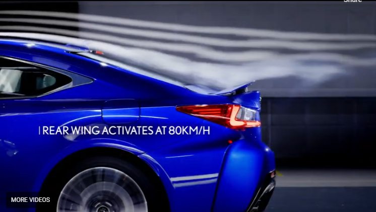

But back on topic. I am intrigued by how you would calc downforce on our wings. I think I saw a video on a wind tunnel with the spoiler up and it didn't show any airflow below the wing. Of course it's just a prom video from Lexus so who knows if that was an accurate wind tunnel vid.
here is the video on that “wind tunnel”

If it fucntions as. a spoiler, then theres no downforce. If it functions as a wing there is a downforce but it's not very much.
So the question on this thread is how much downforce. Do you have your own calc of what that is? So far the answer presented was 40lbs at 80mph. Do you agree? If not why?
i’m really curious…I get the air being shown on the vid shows it going over the wing but is that sufficient enough to produce any real downforce or is it just creating drag?…I dunno…

I don't have a number because there are a lot of unknowns for example: area of wing (sq ft), coefficient of lift (which is dependent on the shape, speed, wing angle, turbulence, etc.). IMO, i think 50-100 lbs at 80mph is reasonable number.

When you were a kid, did you ever stick your arm out the window while Pa was driving and make your hand go up and down by changing the angle of your hand in the breeze? If you look at the rudder on an airplane or boat and see it as a flat plate (like our rear pop up) and see how it causes the stern (rear) of the machine to change direction? That's what is happening. The "flap" is merely changing the direction of the air, action-reaction (Newton), wind goes up= rear goes down. Newton's 3rd law. The pop up has no camber so merely flat plate deflection, no "sucking".

If the flap had camber, I'd mebe agree. But my car's flap is just a flat plate. Nothing but stall on the back side. You can even see that in the video showing the airstream. You do notice that the kid's "wings" have camber, right? Top side is humpier than the bottom?

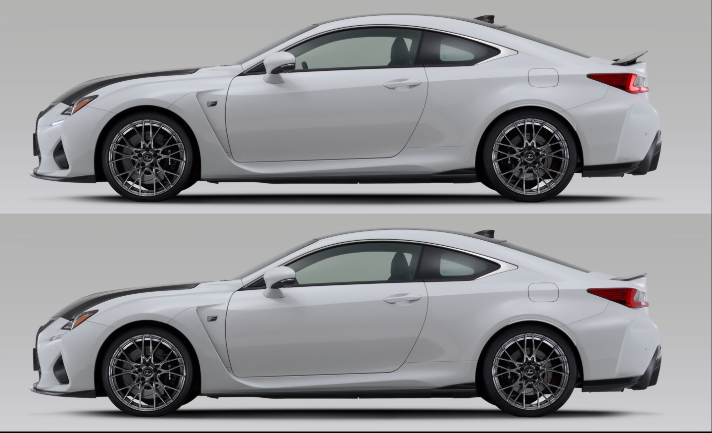

Can you explain further? Are you referring to camber on the actual wing (the way it is designed) or the way it's positioned when it's up?
Are you saying a wing like this would have more downforce (reference link below):
https://www.rr-racing.com/Seibon-Car...rcfsplc001.htm

Most car wings are not flat on the bottom,,,they have a belly...its hard to tell with the RCF wing because there isn't much clearance to see.
Why don't you just go and activate the wing on your car and see?

What I'm saying is that its hard to see if the bottom has a belly or if its straight. Even in the up position there isn't much clearance to see the profile on the bottom side...I will go take a look later today.
If you look at most bigger wings (like on the TE) youll see there will be a concave side and a convex side to the wing.

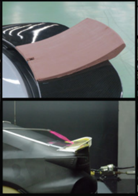

From the video it looks like the wing certainly does something with the air flow. This is a street car after all, so the actual downforce may not be a huge amount, but it's got to be more than zero.
The duck tail shape of the TRD CCSP wing is interesting as well. It definitely has a more pronounced scoop and is claimed to provide some downforce even when down.
TRD CCSP Wing
