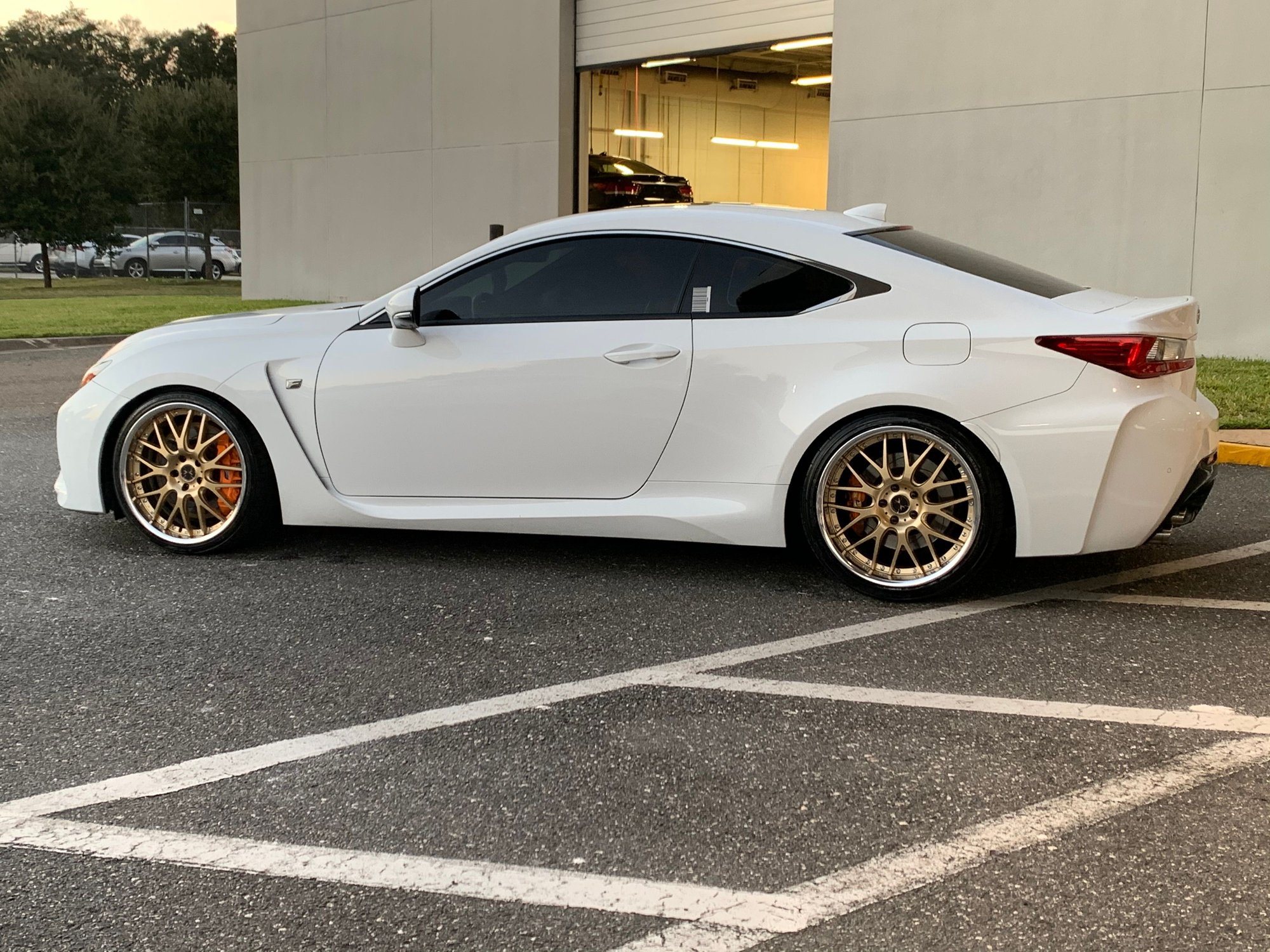

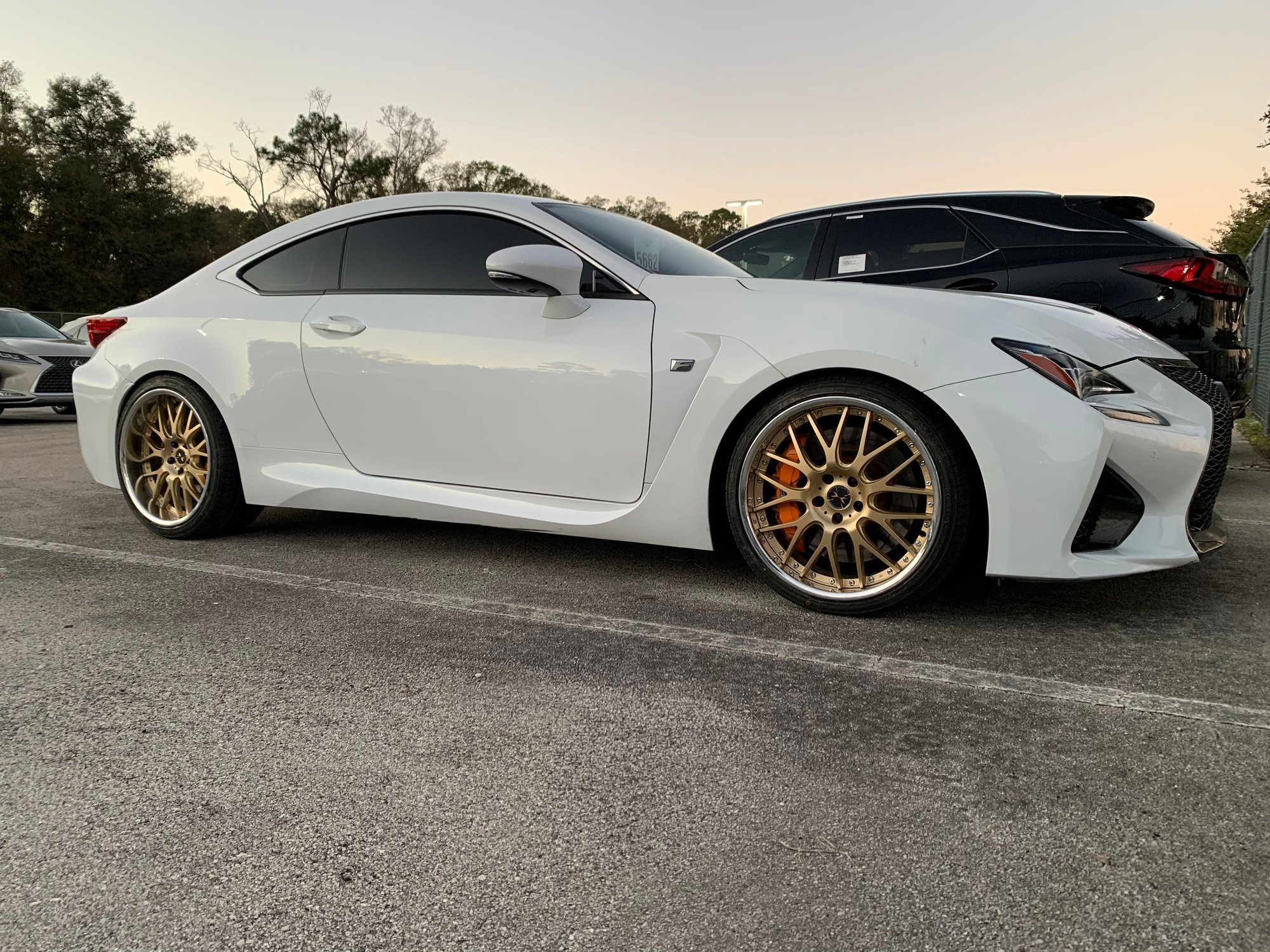

finally got around to some mods... Ran into some issues clearing the rear caliperand had to run a small 15mm spacer out back.
Weds Maverick 709m
20x9 +30mm high disc 255/30/20
20x10.5 35mm 285/30/20 w/15mm spacers
Swift Springs

Nice...wow, paper thin clearance...Looking good man...

It’s actually rubbing the caliper in the pic. We needed at least 6mm to clear. Running 15mm spacers now and it was almost too much to clear the fender

appreciate it... I was looking for a used set of Work VS-XX or similar style and came across these from another forum. They had come off an Infiniti G37 and the offsets were good and I confirmed it was a high disc fitment up front for the calipers.. I didn’t bother to think the rear calipers would be an issue. I can probably run a 5mm spacer and be fine with it but with 15mm it’s almost too flush and just clears by a hair.
I’m pretty happy with the look since I kinda wanted that classic mesh like the vs-xx or racing hart type-c. Just wanted a break from the concave styles that I often see.

Nice wheels. Rear looks pretty aggressive with super deep dish.
