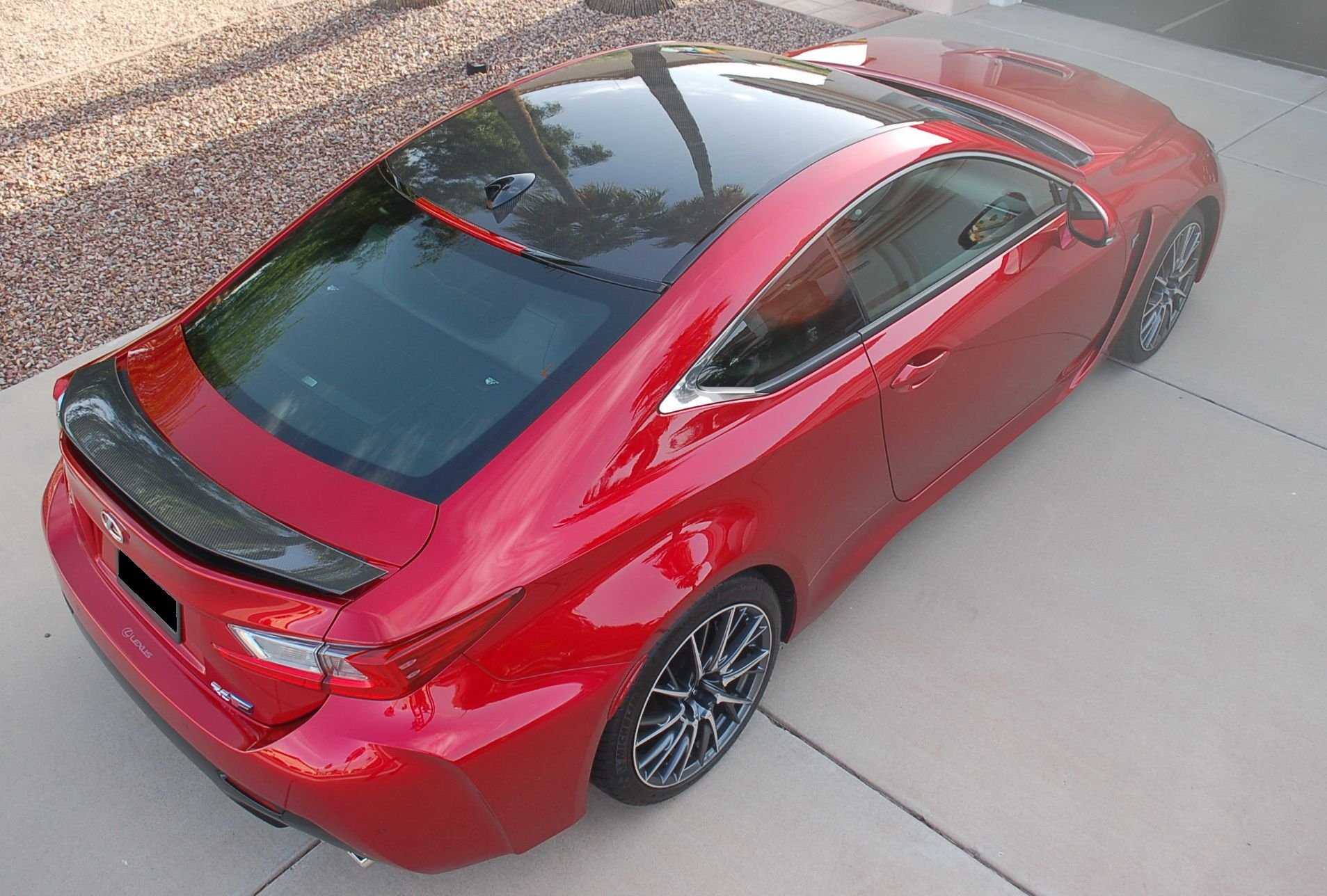

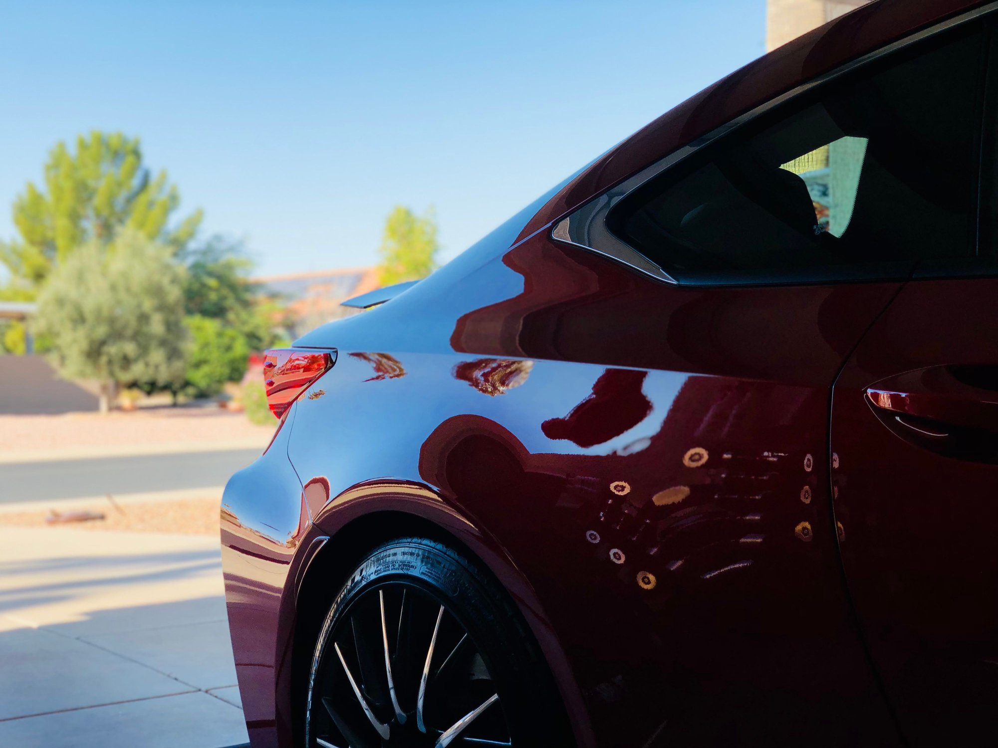

My result is nice, check reflections in CF roof and in the rear fender images attached. (car was coated 2 years ago and maint coat of Ceramic Pro Lite each year, 30k miles now)
