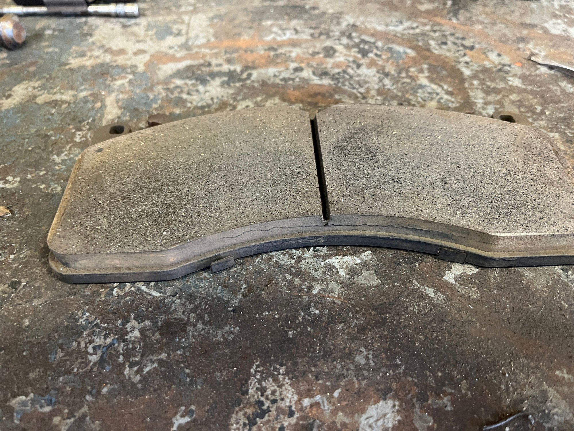

    • For the pads I could not find any part numbers on any of the front pads. They do have shims attached, and they appear to have a minor chamfer on the pad edges, but I have not been able to identify brand/model.

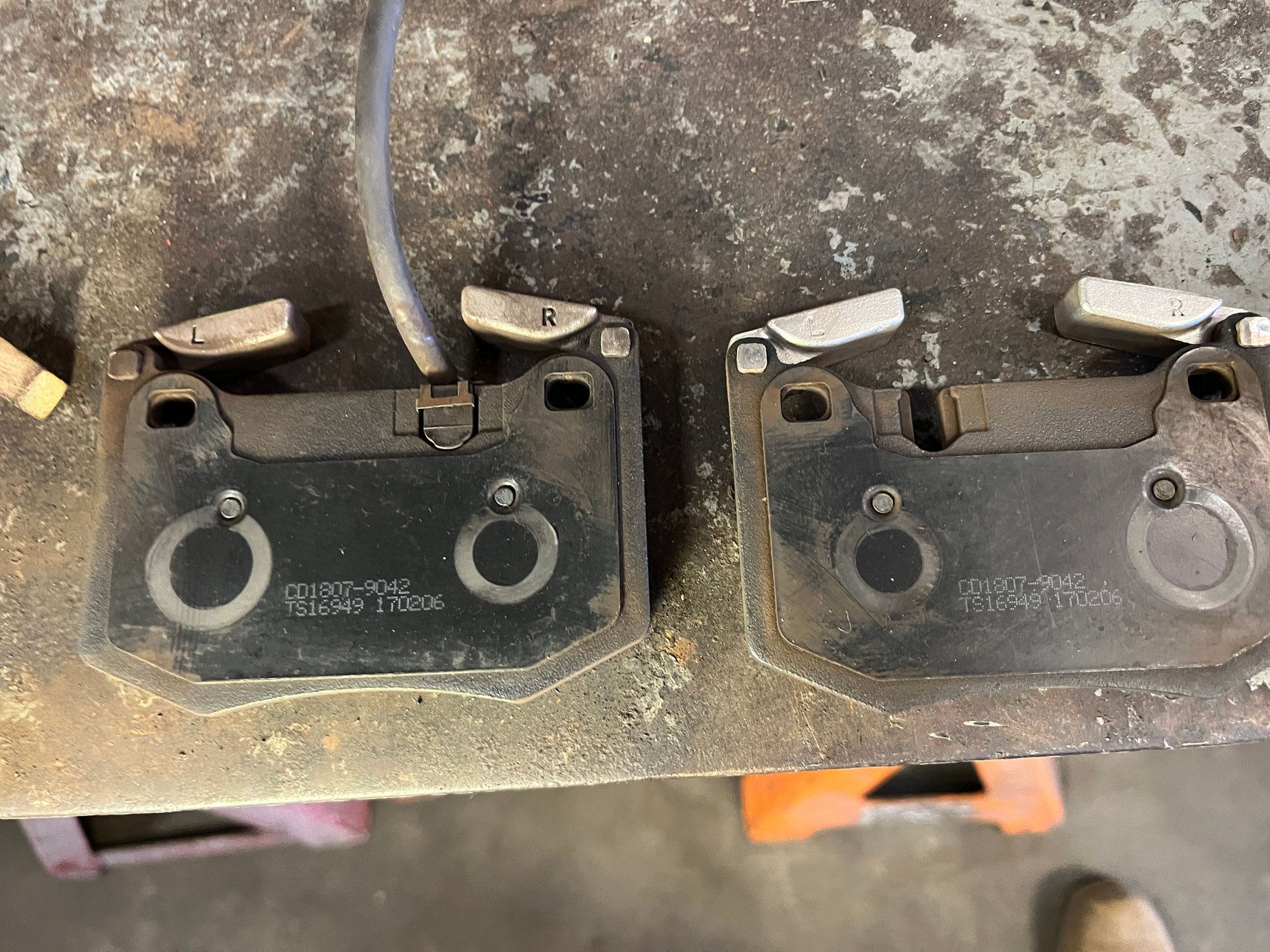

    • For the rear pads I found a part number (see picture), but again looking it up on the web led no where. Have not been able to identify brand/model.

Front pads example
Front pads example
Back of front pad (no part numbers)
Another view of front pad

Rear pads with part numbers
Rear pads
Rear pads

These are not the same, straight cut not curved.
https://www.rockauto.com/en/moreinfo...t=1896&jsn=470
https://www.rockauto.com/en/moreinfo...441354&pt=1896
Those pads bedded in poorly I would not use them again.

All of the brake pads are shot. Measure your disc runout with the dial indicator or micrometer, if it's still within specs ( max disc runout < .05mm), then slap in a set of average brake pads and use it in the meantime until you can replace it with a set of Brembo at the minimum.
I agree, and thanks for the photos. Seems to point even more towards the Brake Performance brand rotors, which is what I suspected I have. Understood on the pads, and not using them again.

Yes, fully agree. I am absolutely replacing the pads regardless. And yes, several have those cracks. I did not highlight it because I am replacing them all. Appreciate the link, but my budget is way less than RCCB.
