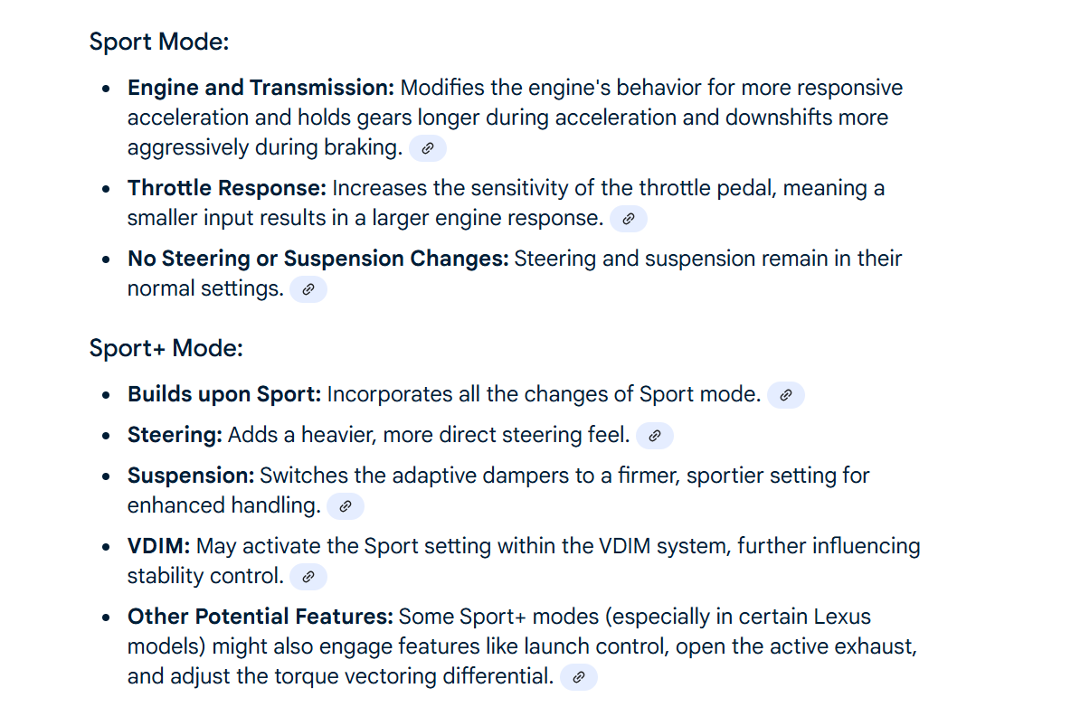

When you dial it up to SPORT+ mode, it is the mode they designed for the race track so the the suspension goes into stiff mode and steering is much heavier, stiffer as well as the transmission shifting is much faster. Once you switch over the MANUAL mode, it will lockup the torque converter for crisp shifts due to the torque converter being disengaged. It will whip your head back shifting at redline.
Here are the differences between SPORT and SPORT+ mode.
