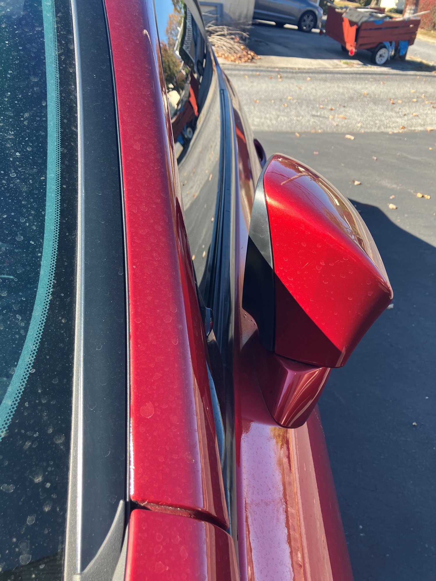

Small update but the RHD modules did fit in the LHD housing. However, the RHD passenger side folds in more than the LHD driver
driver side:
Passenger side:
driver side:
Passenger side:
Yeah that's how my CT is from the pictures above with JDM actuators..lol
You gotta use the USDM driver side and the JDM for the passenger.
Or is that what you did?
Those two pictures look identical to what I have!
Did your driver side mirror fold in that much with the other actuator that you had initially on the first go round?
-Nigel

I only replaced the passenger side with the JDM ones. The driver side is the same LHD/ES one.
It's very strange that the JDM ones fold in way further than the LHD.. I have to wonder though.. what if they don't actually fold that far in when they're in the correct mirror? I never actually plugged the JDM mirrors in when I bought them so I didn't get a chance to see how much they fold in.
I'm going to switch back in the LHD on the passenger side because at least the difference wasn't that jarring..

I can answer that actually. When I bolted on the complete JDM mirror housing without touching anything they folded in identically to what your pictures show right nowl
Everything that I have researched shows the same thing. The passenger side folds in significantlly more for some reason.
I wish we could find someone that had a true LHD RCF to be able to take measurements.
I just measured mine and the passenger mirror extends 4" and on the driver side it extends 4.5".
Driver RCF:
Passenger RCF:
On my CT (same style mirror as original RCF's) you can see how much it folds in on the passenger compared to driver.
