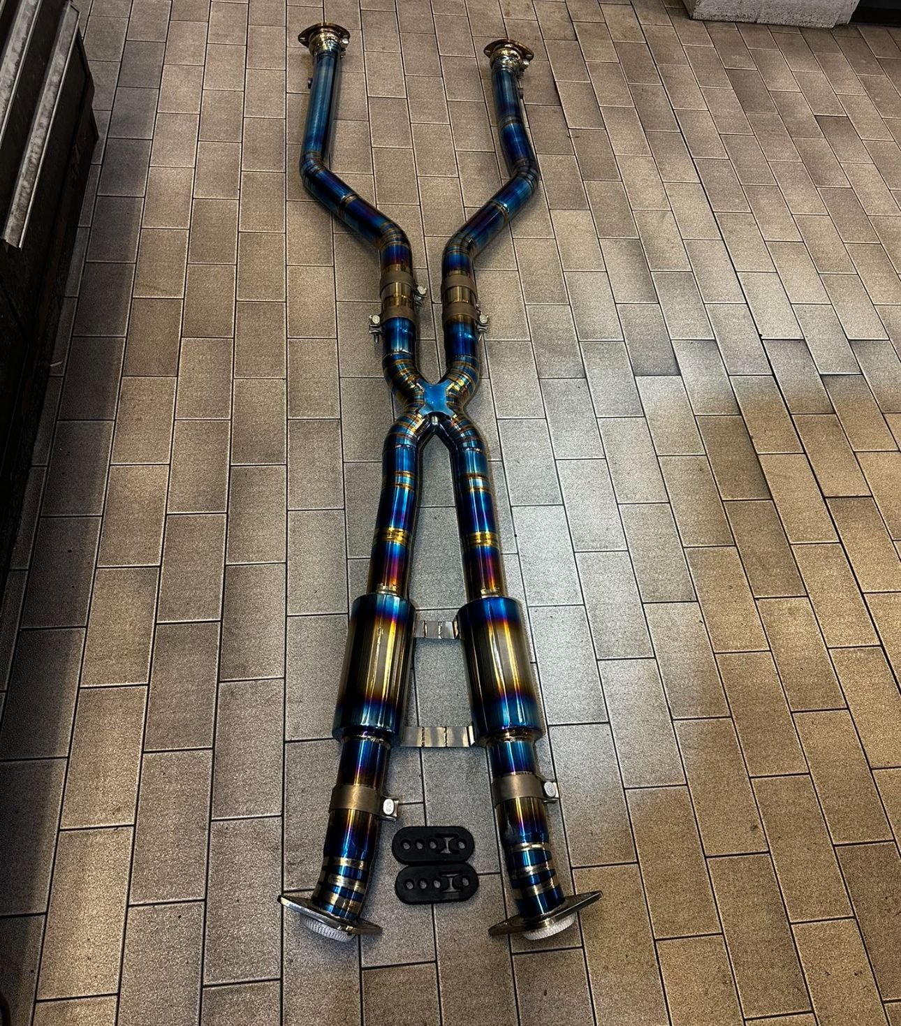

Would RES IS500 midpipe fit on RCF?

IS500 is about 2 inches longer and has a longer wheelbase so the mid-pipe size is different. You might have to cut and weld.

I see two set of clamps in the middle there, if that's for a short extension piece of pipe, then you should be able to remove it in order to fit the RCF. Not a super close up picture, but that looks to be about 2 inches to me.

Agrred!, this could very well be originally RC F application and they just cut and include extension couplers to make up for the needed additional length.
