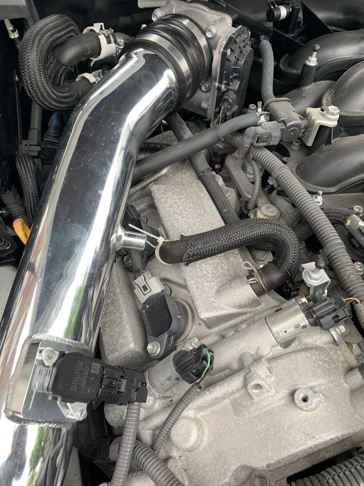

Anybody have an idea why the Trac OFF and Check engine light both came on at the same time when I started the car?

Trac OFF always comes on when the CEL comes on, have you done any mods recently?

I added an intake and a lowered it on springs, but that was about a month ago......

common issues with the aftermarket intakes, check to see if all your hoses are still connected. If not thats most likely whats causing your issue. Read here for more info https://www.clublexus.com/forums/rc-...tall-help.html

Thanks, thats exactly what it was....that tube keeps slipping off.
