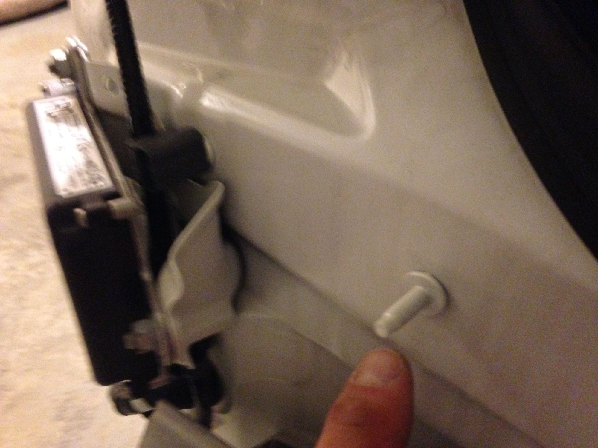

Default Step#2
At the bottom of the left and right sides of the bumper. ( I call them wings ) You will need to remove one push pin from each side. I have already removed the bumper cover in this pic but you should get the location easily enough from it.
